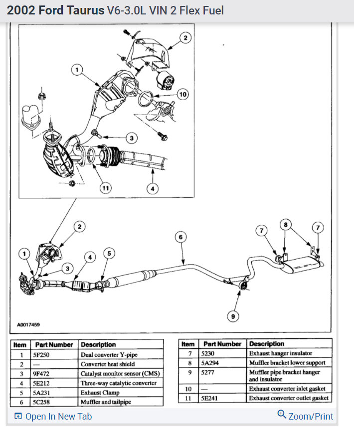

the primary catalytic converters or the front two are the ones you need. the rear is a warm up catalytic converter. I would not replace that one.
the front two come as part of the pipe as in the picture I sent you. it is all one unit.

how many catalytic converter does my 01 taurus have. i had one converter replaced and now my mechanic is saying that i need to replace another one?
Dec 14, 2020 at 7:42 AM (Merged)
PEAR69
  • 1,482 POSTS
Your car has two behind each of the exhaust manifolds here is a guide that can help.
https://www.2carpros.com/articles/how-exhaust-systems-work

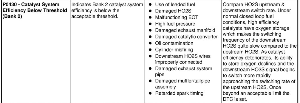

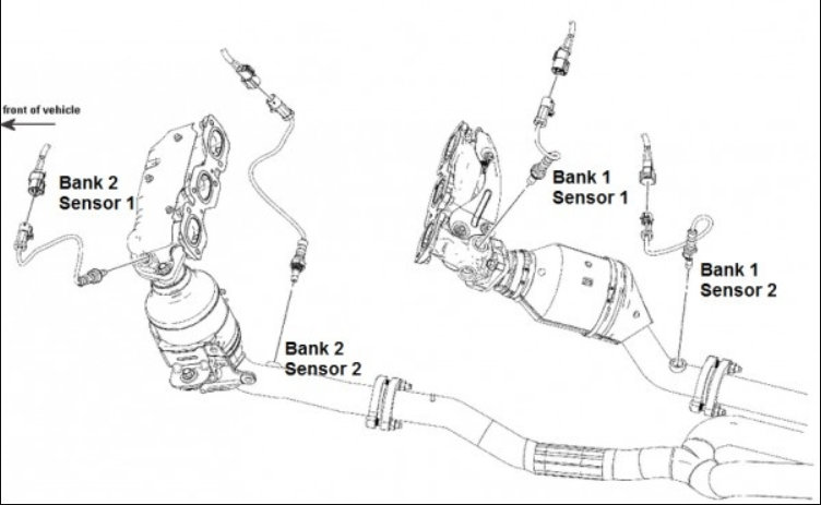

TWUB78
How many catalytic converters are in my car listed above DOHC engine? I am getting a P0430 code and from what I have read this could be issue. any help would be appreciated.
D6SPAN
  • 58 POSTS
HI TWUB78,
The code P0430 is a code for the bank 2 catalytic converter, so it looks like you have two on your car. I have attached an image of the exhaust system, so you can see where bank 2 is. Simply put, of the two, it is located closer to the tail pipe. I have also attached what exactly can cause your p0430 code to show up.
Here is how to test your catalytic converter:
And here is how to to remove it:
https://www.2carpros.com/articles/catalytic-converter-replacement
I hope this helps! Best of luck!
SCGRANTURISMO
  • 4,897 POSTS
There are two, one for each bank of cylinders. Direct Trouble Code(DTC) P0430 is bank 2 catalyric converter is not operating within it's efficiency range. Over time your vehicle's catalytic converter will degrade due to normal wear and tear. When the catalytic converter can no longer due it's job, breaking down exhaust gas into harmless H2O and Carbon Dioxide then DTC P0430 will set. The catalytic converter should be replaced.
