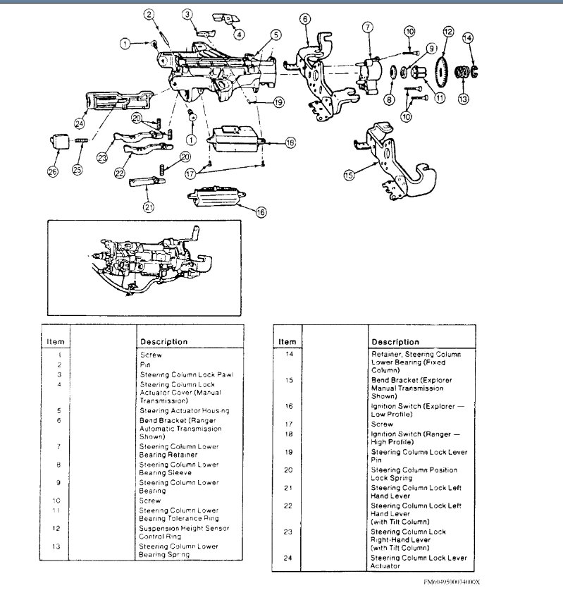

I have a 96' Ranger and the actuator rod going from the ignition to the switch appears to be broken. Have removed the steering wheel and air bag only to see a housing and several springs with retainers, which kind of scare me from going further. I've been able to remove the switch from further down in the column. While I can push the switch by hand and turn the key to get it started, I'd really like to fix it properly so I can turn it on & off with the key. A guy at Ford said it would take him about 2 hours to fix, and he's done several hundred of these repairs.
While I'm an "amature" mechanic, I'm not too bad, often times surpassing common ones, but far from a Ford certified one. Can usually get the job done, but it takes me a little longer. Sometimes a LOT longer. Just wondering if anyone has any experience in tear down, repair, and reassembly as far as the actuator switch rod is concerned. Thanks.
Oct 31, 2007 at 1:22 AM
XXXTINA63
  • 11 POSTS
Bump! Sorry if I sounded arrogant, because I'm not. While I'm not afraid of most things, this steering column and auto transmissions scare me. The Ford tech said I would have to drill out a few pins and replace them with screws. Does that sound right? He also said that all of the springs would have to be removed to gain access to the ignition cover. If it were mine, I wouldn't care so much, but it's my sister's, and I really need to know how to tear this thing down and get it fixed asap. ANY advice is welcome.
Nov 1, 2007 at 5:20 AM
  • 54,837 POSTS
Sure here is the instructions and diagrams in the images below that shows you how to do the job, you will need a large C clamp to help do the repair.

ignition switch

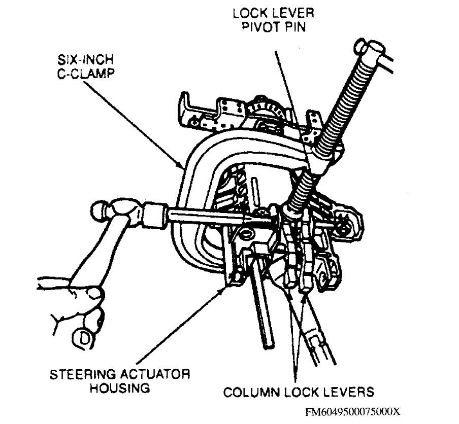

Locking Levers & Springs
33. On models with tilt column, secure locating levers with six inch C-clamp and remove steering column locking levers and springs.

4. Position steering column position lock spring and left column lock lever. Using six inch C-clamp, compress steering column position lock spring while aligning pin hole in column lock lever with pin holes in steering actuator housing. Tap in lock lever pivot pin up to center pin support of steering actuator housing.
5. Insert small nut between column lock lever and steering actuator housing to hold up column lock lever. Slowly loosen and remove C-clamp.
6. Position steering column position lock spring and right column lock lever. Using six inch C-clamp, compress steering column position lock spring while aligning pin hole in column lock lever with pin holes in steering actuator housing. Tap in lock lever pivot pin up to center pin support of steering actuator housing. Align with suitable punch and leave punch in place.
7. Tap in lock lever pivot pin, driving out punch at the same time, until left end of pin is flush with pin support of steering actuator housing.
8. Position nut between right column lock lever and steering actuator housing. Slowly remove C-clamp and remove.

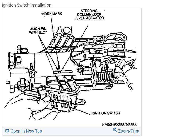

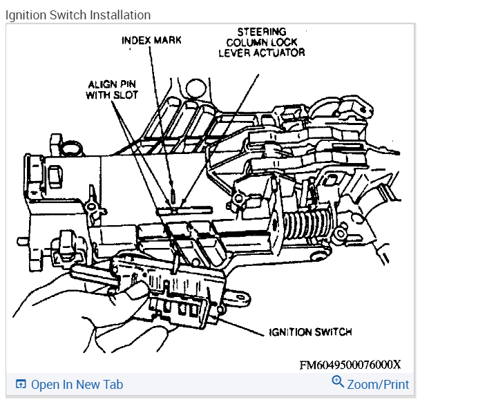

19. Install ignition switch. Align pin from ignition switch with slot in lock/column assembly. Position slot in lock/column assembly with index mark on casting. Ignition switch should be in RUN position. Install steering column lock gear. Coat gear with suitable ignition lock grease.
