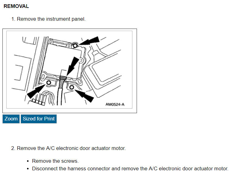

This is a problem with your temperature blend door actuator is going out. Here is a guide and diagrams below of what you need to do to fix the problem:
Cheers

I have a 1998 Ranger with the same problem.
I am attempting to fix mine this way. Almost got it, just needs a little tweaking as to where to put the pin.

Thank you so much for the step by step. One final question, can I drive this vehicle until I find the time to attempt to fix it?

Sure, drive away. Mine has been unplugged while I have been trying to fix it (still trying to find the perfect place for the "pin" and no time to do it). Since that piece is broke on the blend door it does not matter whether or the actuator it is plugged in or not. Everything in mine is the same as it would be if it were plugged in.

The temperature is controlled by the use of an air mix door that is operated by an electric motor/actuator. This door can be jammed or the actuator can be inoperative or have stripped plastic gears internally.
