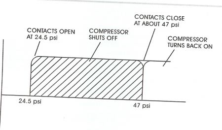

I have a 97 ford ranger 103,000 miles 4 cylinder manual. My AC works fine going down the road. When I stop the engine idles down and my compressor stops running.

It's look like the clutch is not engaging when the engine idles.
Have a voltage test done on the clutch terminal and find out if you get 12 DC volt on the coil.
And let me know

I was think of a bad cycling switch. At idle the head pressue is not up so the switch is kicking the compressor off. Could also be a little low on freon, where it won't keep the switch inguaged. Hope this helps. Will follow this one more 8) NOS

Does the compressor stop running or is it just not providing any cooling?
You can look under the hood to see if the compressor is working. The clutch only spins when the system wants cooling.
If the compressor is working, then you probably are low on refrigerant. The compressor only works as hard as the engine. If you are low on refrigerant, you woun't get much cooling at idle.
If the compressor isn't spinning, follow the instructions provided by "mathiaso" and "NOS".

I agree with you guys ( Nos and bhugg)
it's dangerous to work on air conditioning for the home mechanic.
https://www.2carpros.com/forum/automotive_pictures/46384_scan_6.jpg
The cycling pressure has contacts that remain closed until the presure reachs about 24.5 psi.They remain open untill the presure rises to about 47 psi, at wich point they close again to re-energize the clutch.
My question is: Is it really enough refrigerant in the system?
My second question is what happen when a fused jumper is placed across the switch's contact?
I want to know if the clutch energize.
