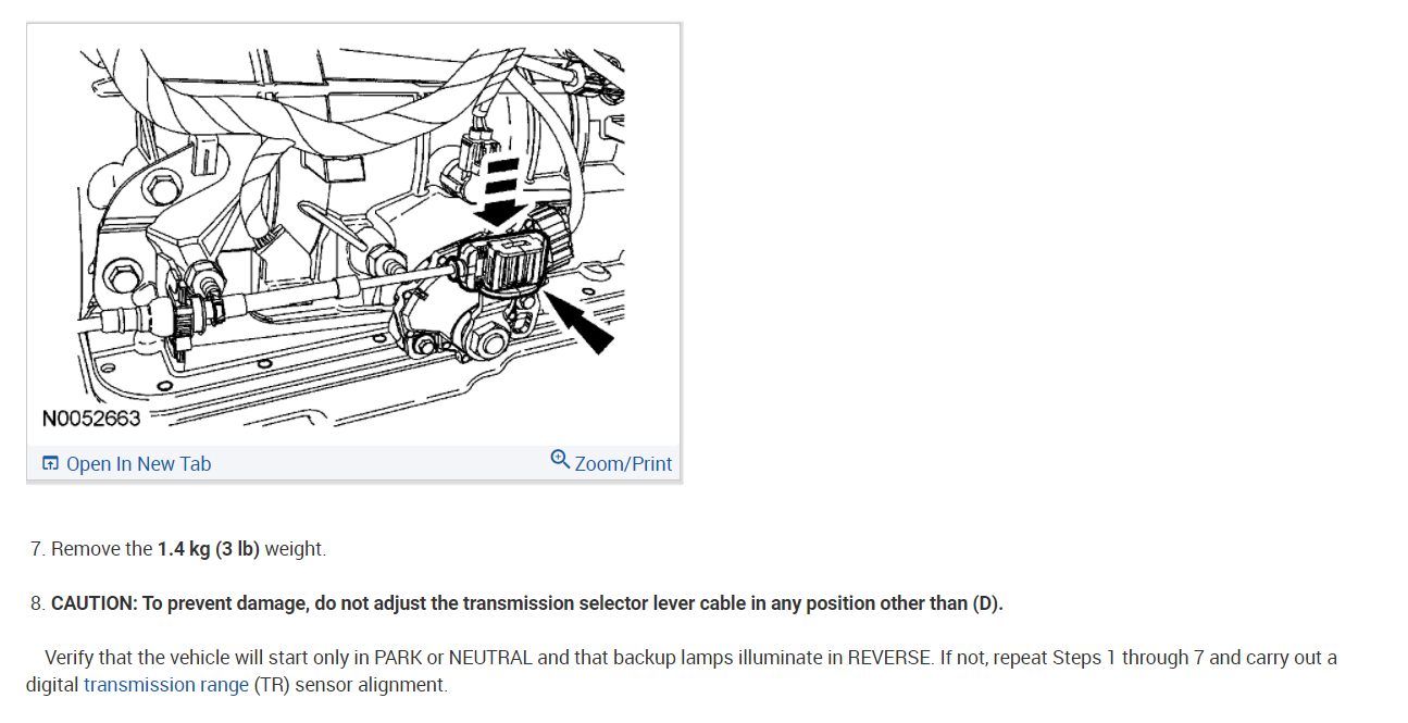

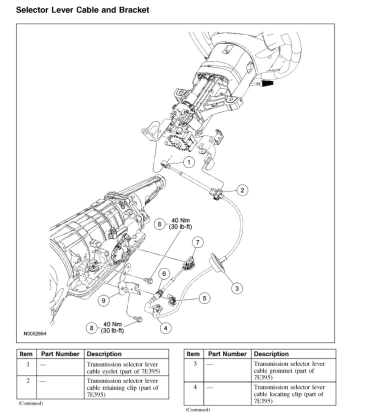

Usually when I put the truck in park, it doesn't always "click" into park position. I usually have to either rock my body forcefully forward to get it to click into park or put it back in drive and edge a little forward and try putting it into park again. It is a real pain because if I don't make sure it is fully in the park position, my alarm system ends up going off full blast in the middle of the night because it clicked into park. I was just wondering what would cause it to not fully click into park. Someone told me it was something as simple as a spring but I have more faith in you guys and would like your input. Thank you so much!

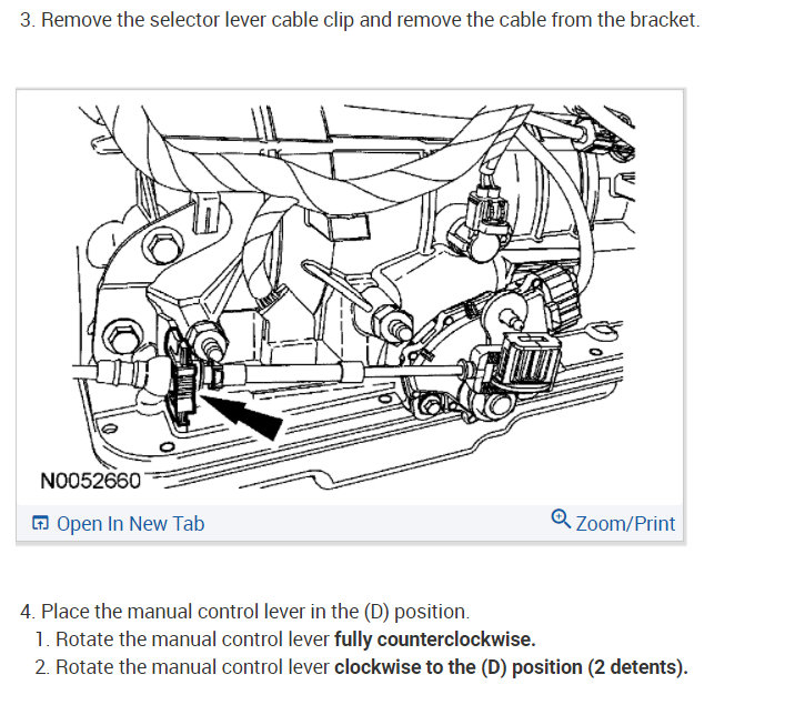

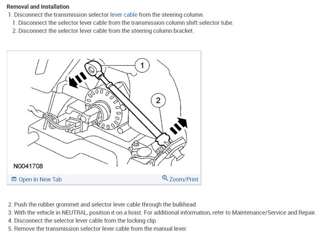

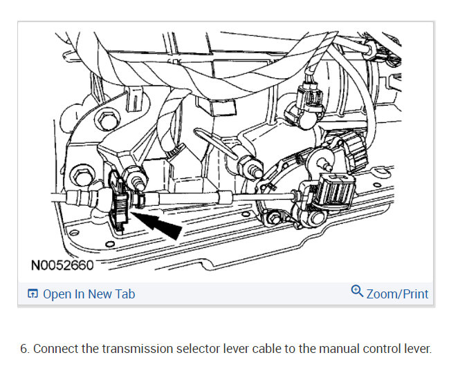

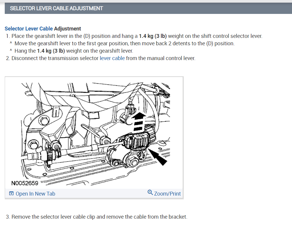

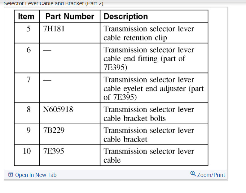

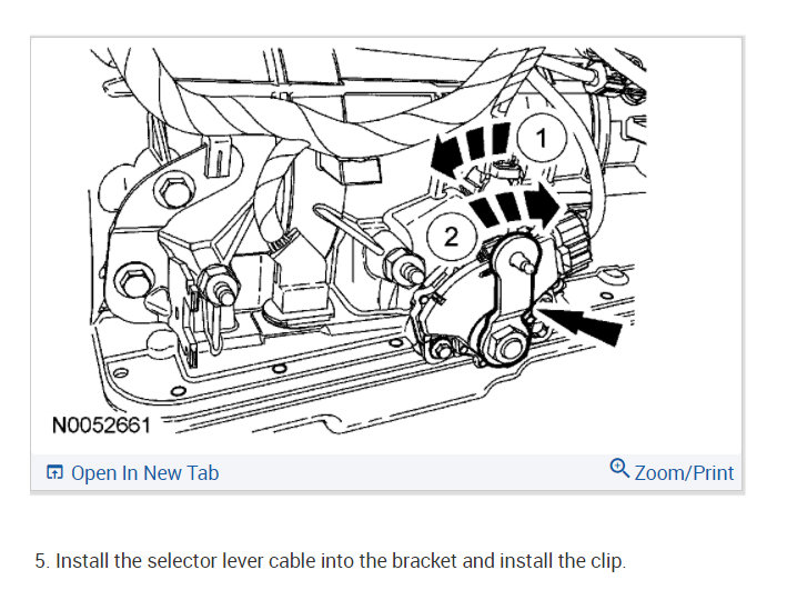

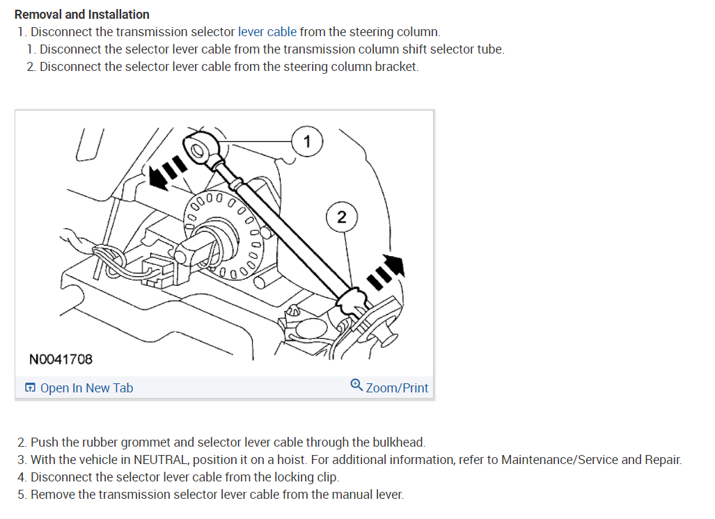

Here is a guide to help you step by step with instructions in the diagrams below to show you how to replace the shifter cable. Check out the diagrams (below). Let us know what happens and please upload pictures or videos of the problem.
