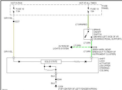

I cannot get truck out of Park. The Key turn, and the truck start up I cannot move it's into park.

The truck is equipped with a shift lock out if the brake light do not come on it wont come out of park. First thing i would check are the bulbs next check the brake light switch.

So, Fordman16 are you saying I should check to see if the brake light are working?

Yes check the brake lights to see if they are working if not check the bulb ,fuses and brake light switch

HAve you checked the fuses for the shift interlock?
https://images.2carpros.com/forum/automotive_pictures/30961_ranger_inter_1.jpg
