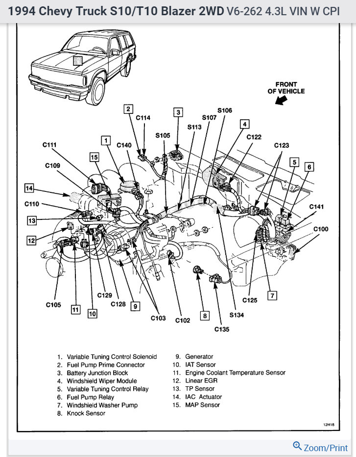

Good afternoon,
Correct. The basic blocks are the same. It is the add ons that are different for each application.
