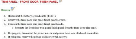

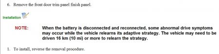

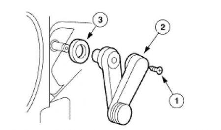

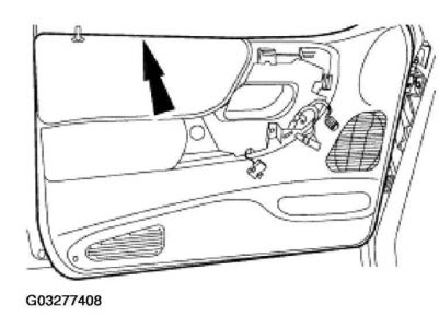

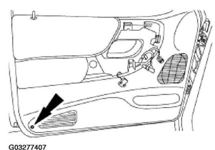

I need to remove the passenger door panel to replace the window motor. I'm a Lexus trainee but have not done much work on my own truck but my window motor is sketchy at best. Pics would be helpful if you have any.

https://images.2carpros.com/forum/automotive_pictures/261618_Noname_2904.jpg
https://images.2carpros.com/forum/automotive_pictures/261618_Noname5_67.jpg
https://images.2carpros.com/forum/automotive_pictures/261618_Noname6_30.jpg
https://images.2carpros.com/forum/automotive_pictures/261618_Noname2_957.jpg
https://images.2carpros.com/forum/automotive_pictures/261618_Noname3_343.jpg
https://images.2carpros.com/forum/automotive_pictures/261618_Noname4_154.jpg
