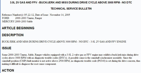

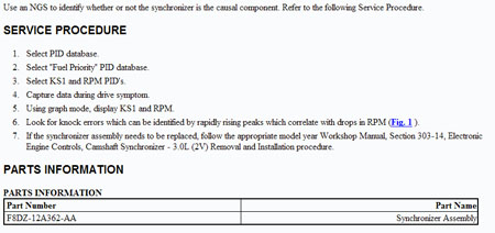

Here's a TSB tidbit I found on it...200-2003 Rangers Sables, and Taurus...CMP synchonizer problem 3.0 engines?
https://images.2carpros.com/forum/automotive_pictures/62217_Bucka_1.jpg
https://images.2carpros.com/forum/automotive_pictures/62217_Buckb_1.jpg
