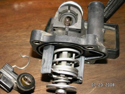

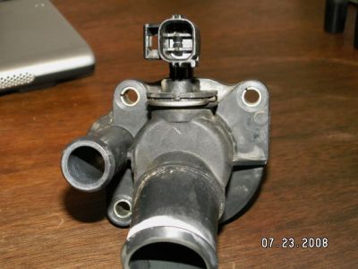

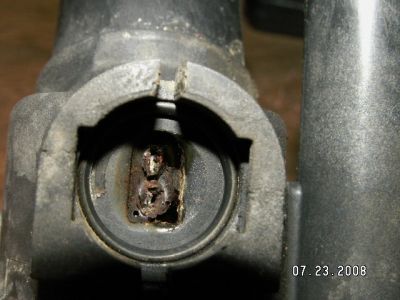

2002 Ford Ranger 2.3L 4cylinder p1432 code I had this code too. The dealer charged me $130.00 to tell me it's the electronic thermostat and wanted $500.00 more to fix it. I located one on Ebay and put it on myself for about $110.00. After I got the new one installed the auto parts dude reset the check engine light and I am good to go. I inspected the old unit and sure enough the little tiny connectors on the wire plug looked fried and black. I had to remove a keeper clip to pull that wire connector out for inspection. So based on my experience if you're getting P 1432 code and a fried connector it may be time to replace the electrionic thermostat. Also of note is that I purchased a 2001 2.3 ranger thermostat. The folks that sold it said it's the same part so I trusted them and It's working well so far. After closer inspection it looks like I broke the wires off a thermistor coming out of the thermo housing. It appears that the thermistor is imbedded in epoxy and it's fried to a crisp.
