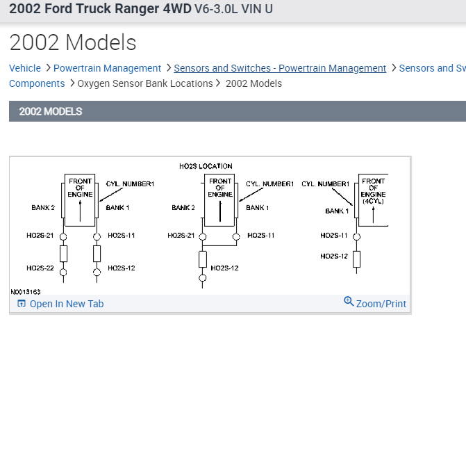

Left and right bank running lean, what o2 sensors do I replace
2002 FORD RANGER
53,000 MILES • 6 CYL • 4WD • AUTOMATIC
KARL HIRSH
left and right bank running lean,what o2 sensors do i replace
Mar 6, 2009 at 1:04 PM
SQM
  • CAR REPAIR CONTRIBUTOR
  • 6,383 POSTS

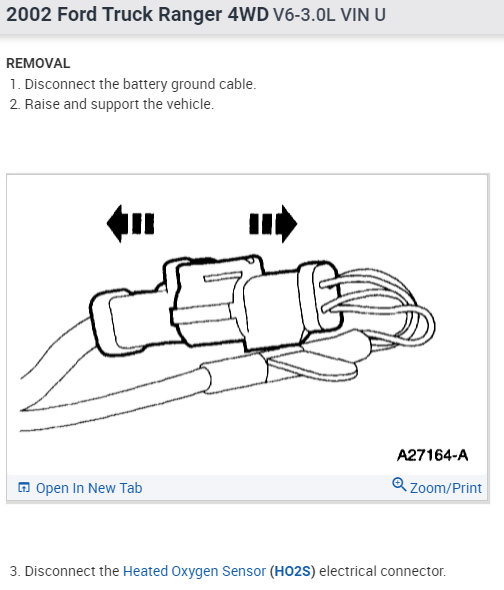

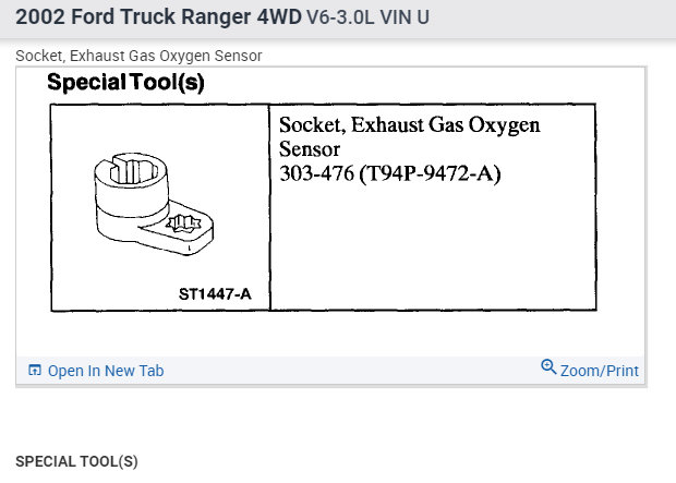

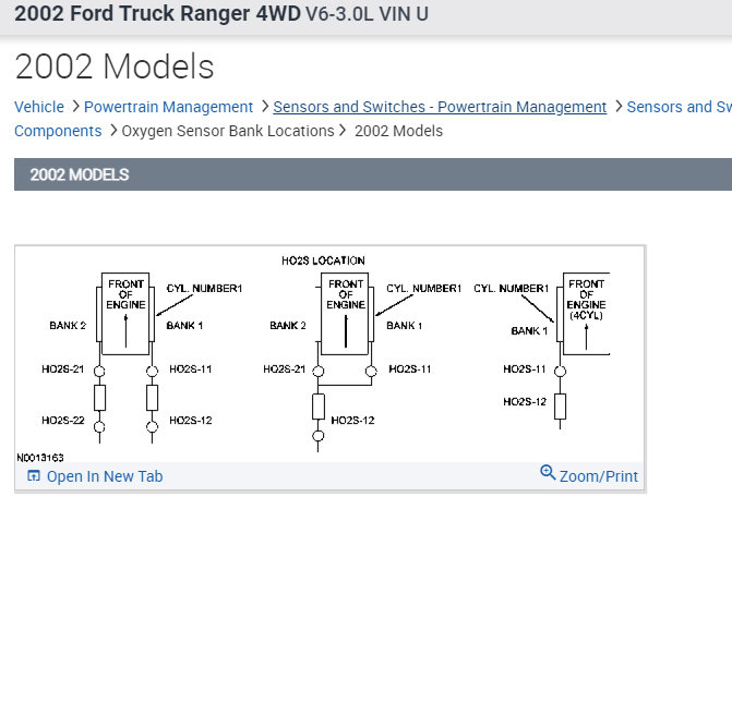

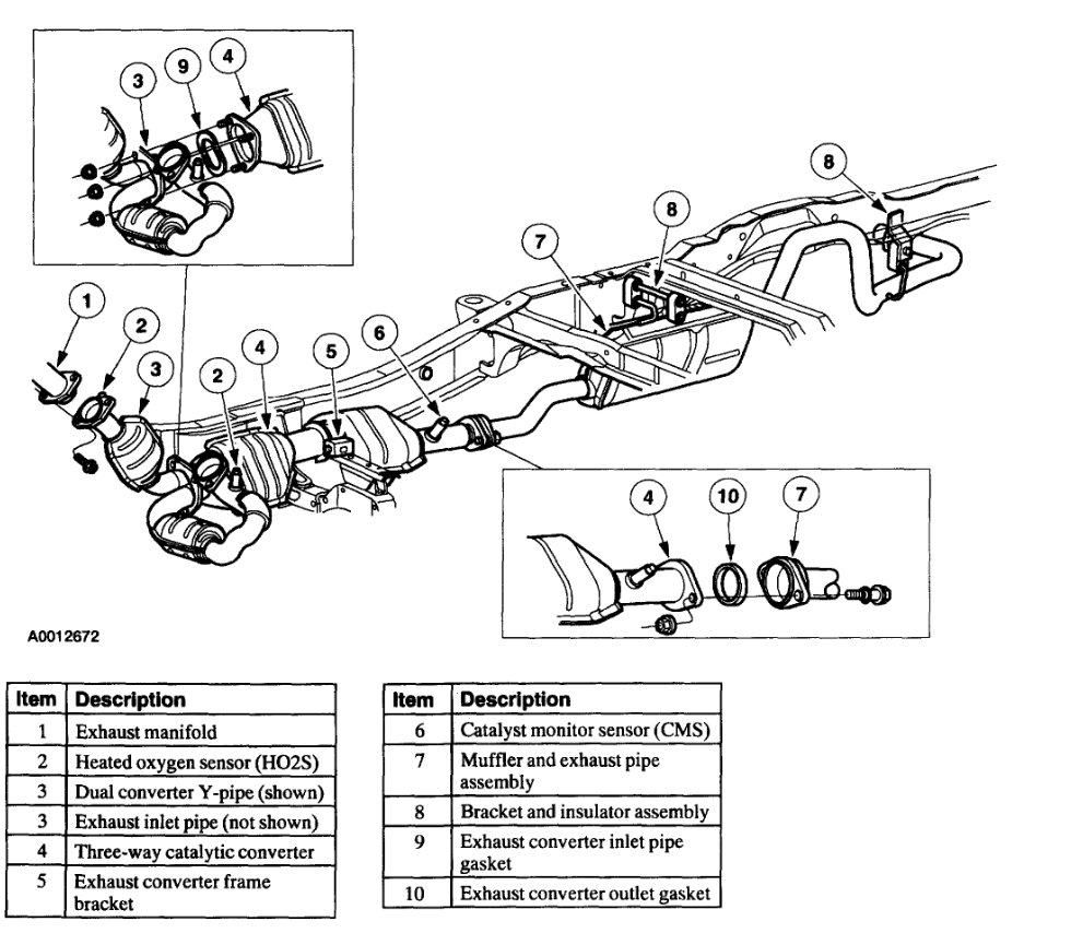

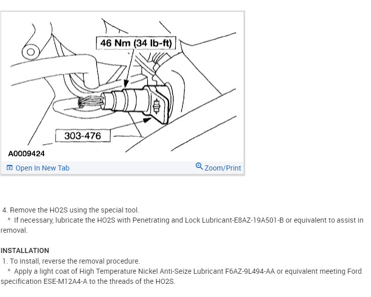

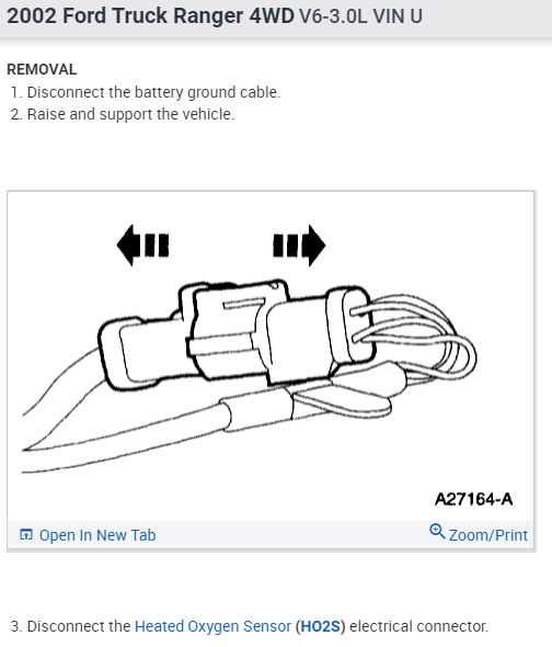

This vehicle with the 3.0 V6 has 3 oxygen sensors.
Two of them are upstream or before the catalytic converter and one downstream after the catalytic converter.
The two upstream sensors are divided into bank 1 (left hand side) and bank 2 (right hand side).
Please keep in mind that depending on the code it could be a related item and not the oxygen sensor that is triggering the engine light.
What is the code that you have?
