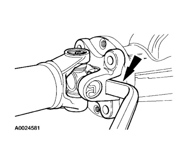

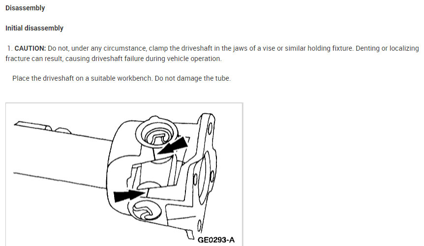

When i shift from either park to reverse or to drive or back and forth between the two i hear a clunking noise that comes from the differential when the gears are engaging. i don't know if it is something to be worried about or if it is just the flaw of the vehicle all i know is it never made the nois before when my parents drove it and it also sat at year not being driven so i don't know it that would have anything to do with it?
Aug 2, 2010 at 3:45 AM
DANNY L
  • 5,648 POSTS
Hello, I'm Danny

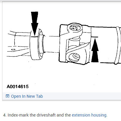

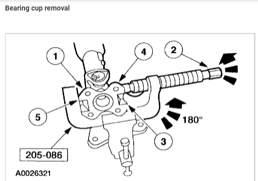

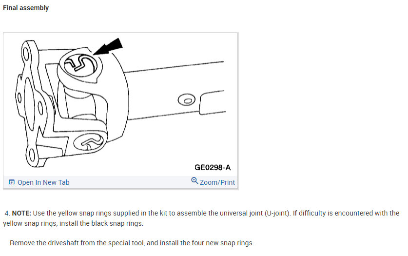

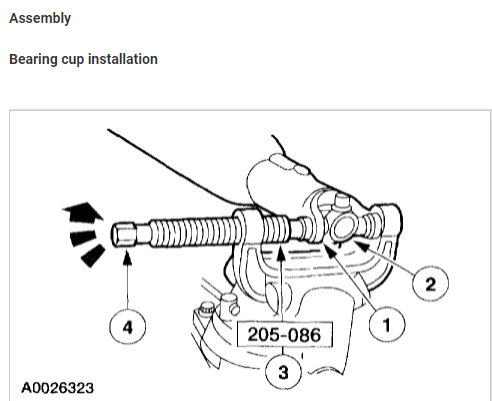

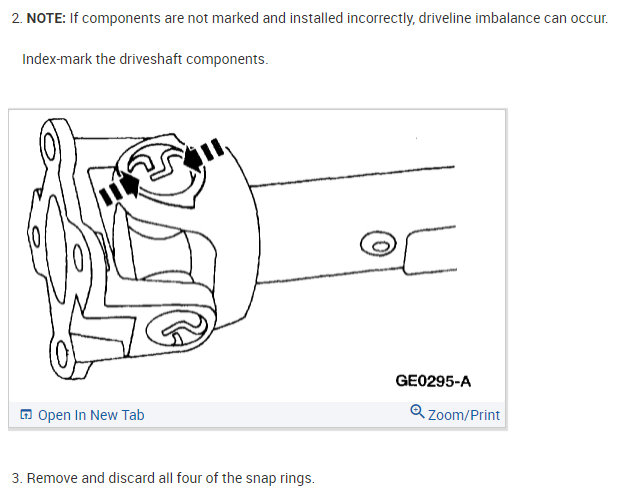

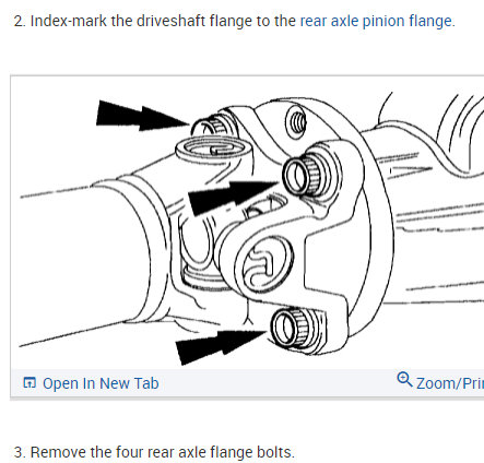

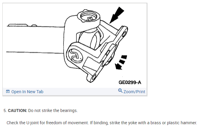

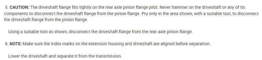

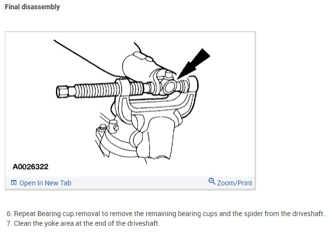

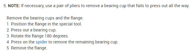

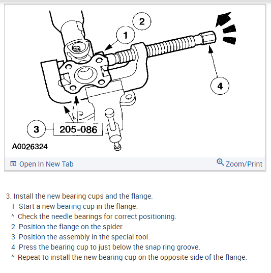

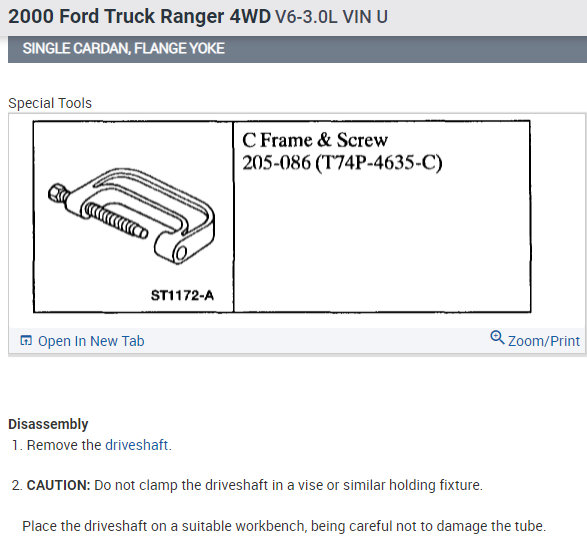

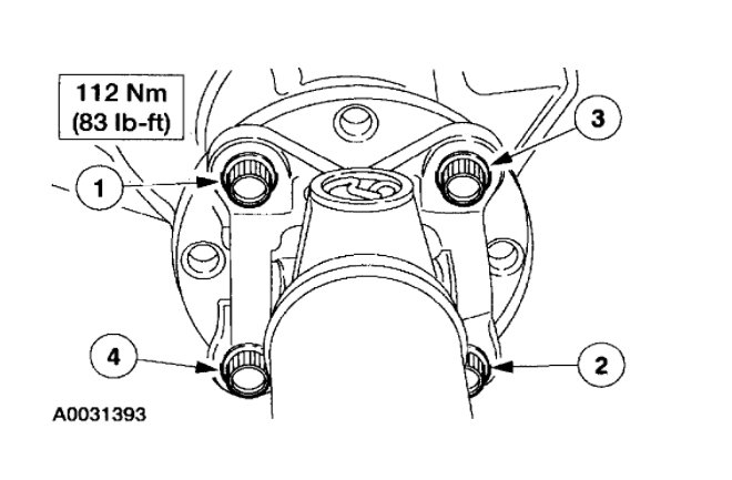

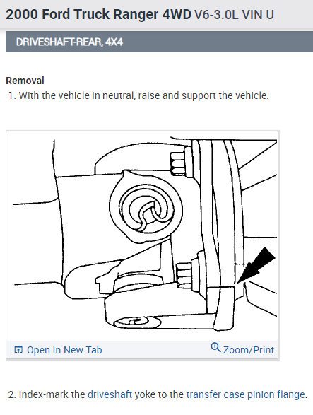

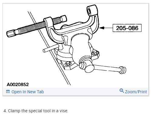

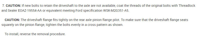

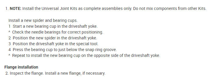

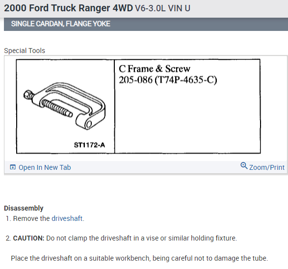

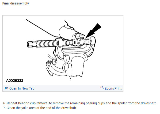

Here is the information you requested. You will need to remove the driveshaft from the truck to ease in replacement of the u-joint. Here is a tutorial showing how to remove and replace a driveshaft.
https://www.2carpros.com/articles/how-to-remove-a-drive-shaft
I've attached picture steps below on how to remove the driveshaft and replace the u-joints on your Ranger. Hope this helps and thanks for using 2CarPros.
