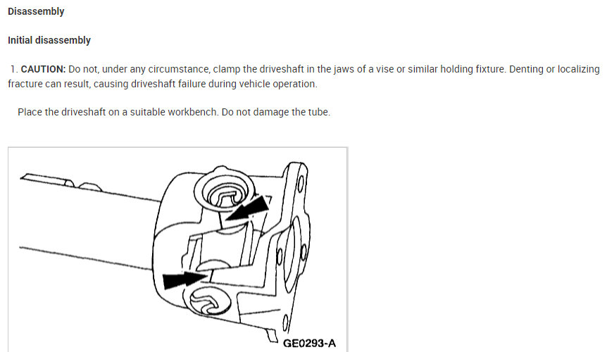

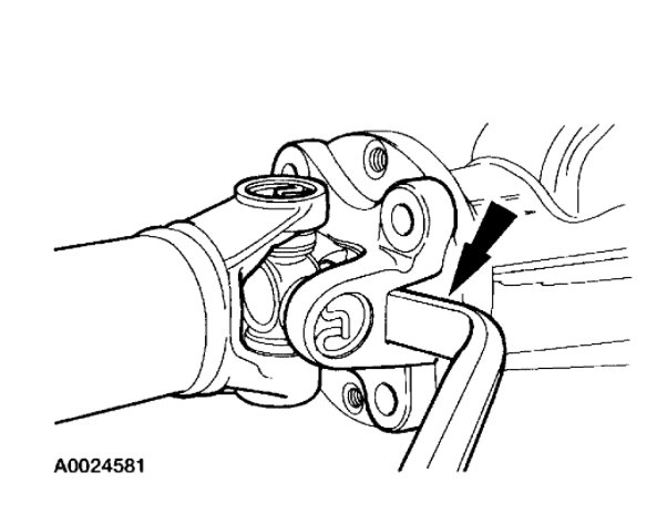

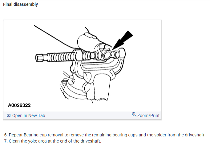

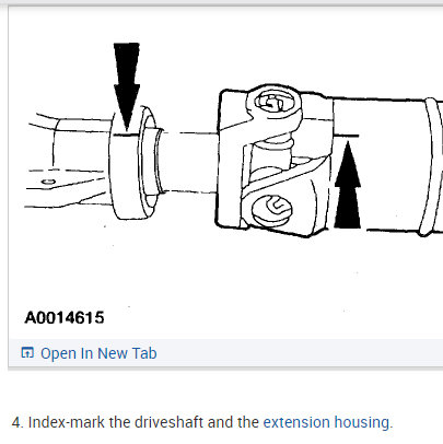

i have a ford ranger fx4, when ever i get on the gas i hear a squeaking clucking noise right about where the rear I think the U joint is bad.
Mar 16, 2009 at 11:34 AM
DANNY L
  • 5,648 POSTS
Hello, I'm Danny.

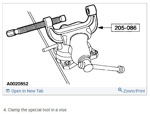

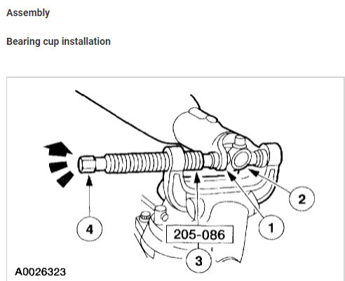

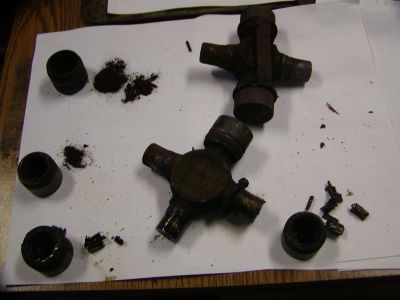

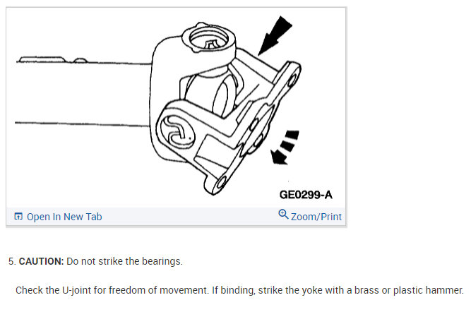

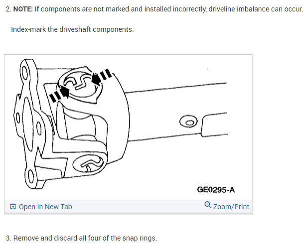

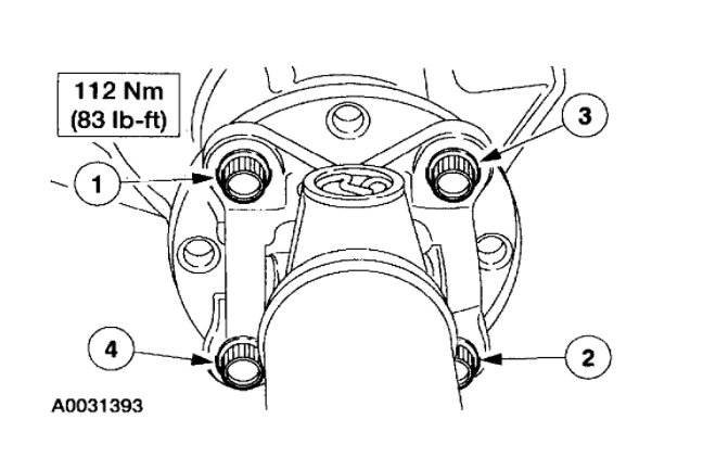

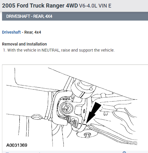

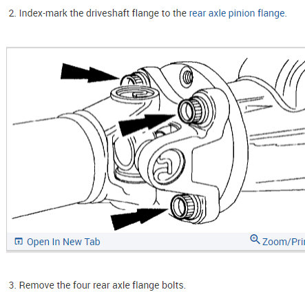

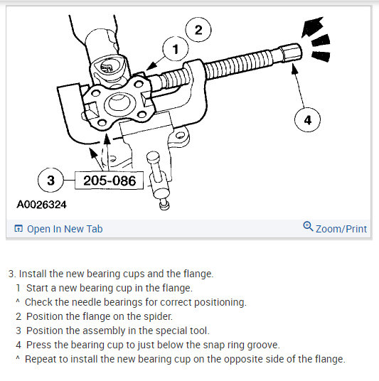

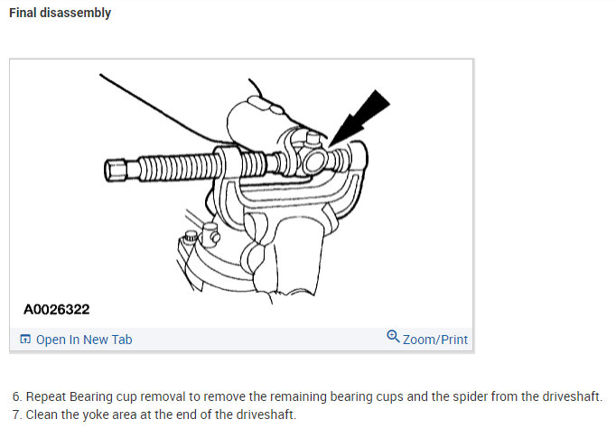

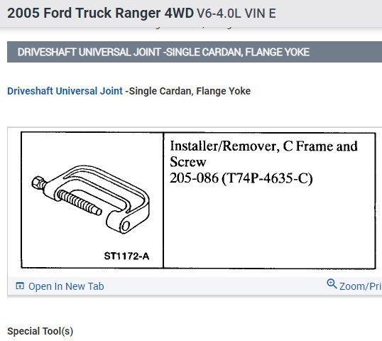

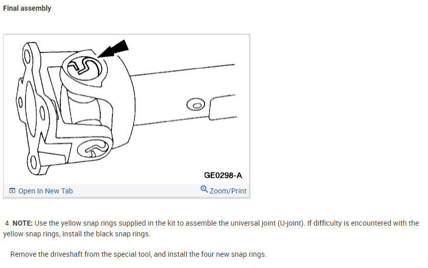

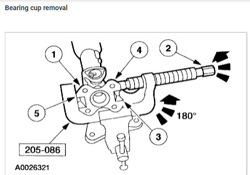

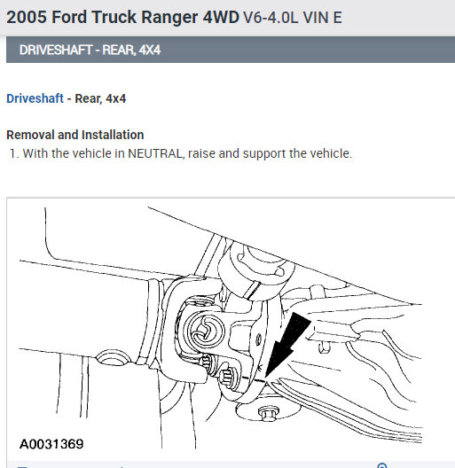

Here is the information you requested. You will need to remove the driveshaft from the truck to ease in replacement of the u-joint. Here is a tutorial showing how to remove and replace a driveshaft:
https://www.2carpros.com/articles/how-to-remove-a-drive-shaft
I've attached picture steps below on how to remove the driveshaft and replace the u-joints on your truck. Hope this helps and thanks for using 2CarPros.
