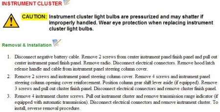

ADOBRENZ
Ok my truck just failed California smog check because the check engine light does not function. I guess the light is burned out? Is this something that I can replace? I asked at autozone if this was a part that they could get and they told me it was a dealer specific light. Apparently there is some history of the truck that I am not aware of. I bought it used in Wyoming and then moved to California. It is the 3.0 liter V6, automatic and 4X4. Thanks for any help.
Nov 27, 2020 at 2:16 AM (Merged)
BLUELIGHTNIN6
  • 16,542 POSTS
Hello Below is info you requested.
https://images.2carpros.com/forum/automotive_pictures/261618_Noname_49.jpg
https://images.2carpros.com/forum/automotive_pictures/261618_Noname2_18.jpg
If engine light stays on once bulb is installed, get the codes pulled and post them and I will be more than glad to help you solve the issues.
