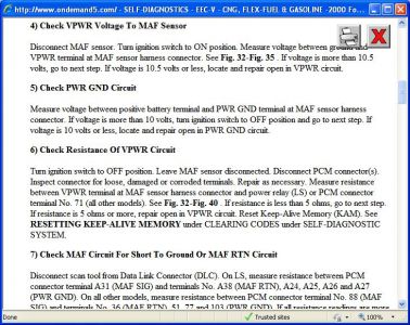

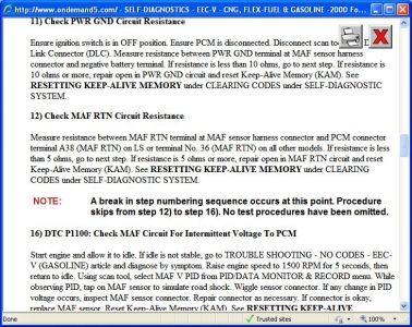

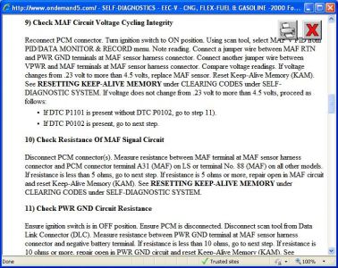

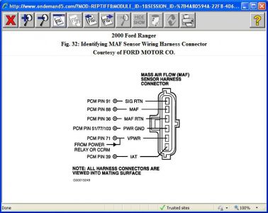

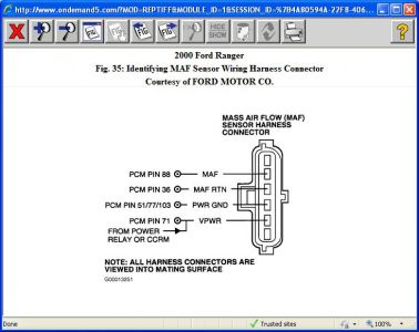

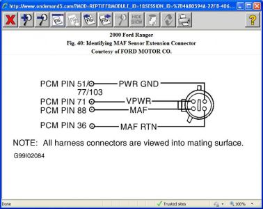

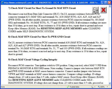

I have a 2000 4WD with about 126,000 miles. Recently, my check engine light came on. This is the first time ever and after making sure the gas cap was on tight and a couple other "by the manual" checks the light has not gone off. It has been over a week now, but there does not seem to be any difference in driveability and no noticed problems. The only possible clue comes recently when I stop at a light or something and the RPMs take an unusually long time (over 30 seconds) to fall from about 2,000 down to normal idle speeds of around 700. A repair shop ran tests and initially didn't find anything besides a couple "system lean" errors on their computer. They suggested cleaning the Mass Air Flow (MAF) sensor or a vacuum leak somewhere. Are they guessing or is there a more plausible explanation?
Wednesday, January 7th, 2009 AT 1:05 PM
65 Replies
  • 109,874 POSTS
Hi:
With an engine code, you really can't be 100% sure. The code can direct you in the right direction, but it doesn't give you an exact fix all of the time. What they are suggesting may infact be the problem, but they will need to try them first.
Lets get the codes use this guide
As far as the possible vacuum leak, check for yourself. Open the hood and look for dry rotted vacuum line, broken ones, disconnected ones... Also, with the engine running, see if you can hear a hissing noise coming from anywhere. That will lead you to a leak.

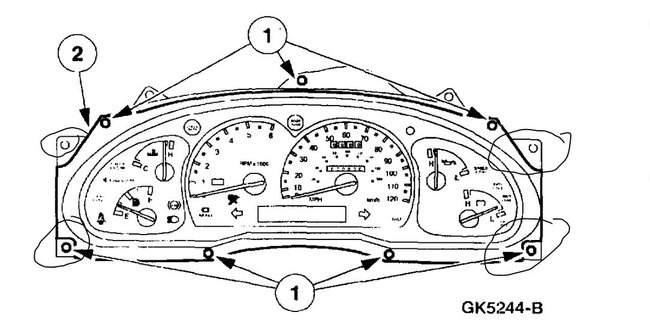

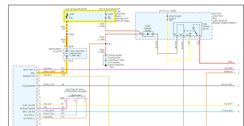

My check engine light stopped working and I cannot seem to find the bulb size of just that one bulb. Do I need to replace the whole cluster because one indicator bulb went bad? Please help

Good morning,
Did you verify power to the bulb? I would not assume the bulb is bad until you confirm voltage.
There is a fuse for the light. Verify power from the fuse to the cluster.
Friday, November 27th, 2020 AT 10:12 AM (Merged)

  • 52,797 POSTS
It is in the fuse box under the left side of the dash.
You will need a test light for this procedure.
Friday, November 27th, 2020 AT 10:13 AM (Merged)

  • 52,797 POSTS
It is fuse 11.

  • 52,797 POSTS
No, it is just for the check engine light.

So I checked the fuse and it isn't burnt out. What are my next options? Is it possible to replace just the check engine light bulb? I don't have anyone who can't check the voltage to the check engine light.
  • 52,797 POSTS
You need to verify voltage to the light before assuming it is the bulb.
I do not guess. I diagnose and work the problem. If you do not have a test light or voltmeter, see if you can borrow one.
As far as the bulb, they do not give you access to it for security reasons.
It could be the wiring, the cluster or the PCM. That's why we need to do testing.

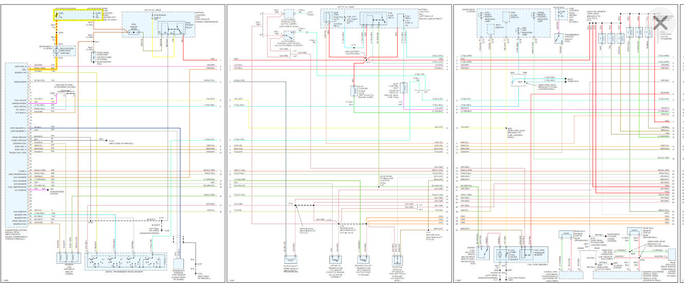

Okay so I finally checked the fuse with a meter and on the continuity setting its reading fine. What is the next step?
  • 52,797 POSTS
Okay, the next step is to verify power into the cluster in the wire shown in the diagram I attached in the beginning. Verify voltage to the wire and the one coming out as well. The colors are marked on the diagrams.

No, you need to remove the cluster to access the connector behind it.
