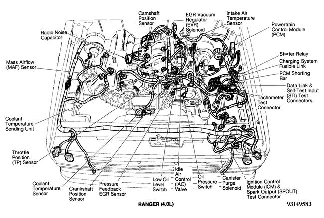

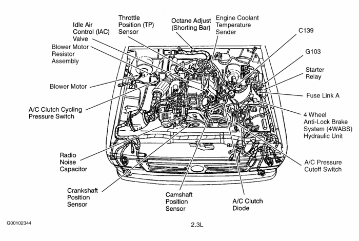

Where is the cmp and ignition control module on a 1993 2.3 L Â ford ranger xlt

DAVE H
  • 13,384 POSTS
Hope this helps
https://www.2carpros.com/forum/automotive_pictures/266999_cam_2.jpg

199340RANGER

Where is it located at?

ED-WEEZY21
  • 248 POSTS
This is the best picture I can find with my available resources. It looks like its next to the intake on the firewall side.
