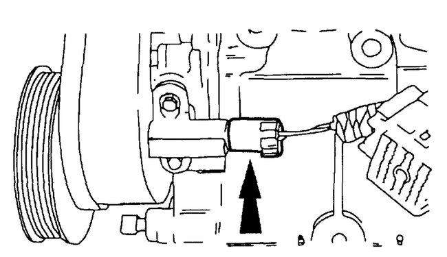

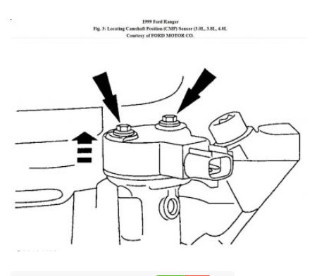

Where is the Camshaft Position Sensor located on 99
2WD 3.0L Flex fuel 6cyl?
Sep 14, 2010 at 6:33 AM
WRENCHTECH
  • 20,761 POSTS
The cam sensor is located where you would normally find the distributor. The top plastic piece is the actual cam sensor and the piece it's mounted on is called the synchronizer. DO NOT disturb the synchronizer unless you have the knowledge to mark it's position properly before removing or you have the tool required to reset it's position. Check out the diagrams (Below). Please let us know what happens.

JLYNCH777
i just replace my camshaft sensor when i was doing that i notice that it just was spending around. is there i screw or a pin that goes in it or something?
Jun 30, 2020 at 5:58 PM (Merged)

JLYNCH777
the check engine light was on and it told me to replace the camshaft position sensor. when i was doing the i put the the new one on and it would just spin. if you can call me.
KHLOW2008
  • 41,814 POSTS
There are supposed to be 2 screws to hold the sensor in position.
JLYNCH777
i did that. the sensor and the thing that the sensor gos on spins to.
what is the hole for under where the wires hook up at?? is there a pin or a screw go in there so it wount spin??

KHLOW2008
  • 41,814 POSTS
The sensor is plugged into housing and can be turned but not freely. check if the seal is good/correct. there are no pins or lock as explained in the shop manual.
The only advice offered was to note the wire connector position before removal of sensor.

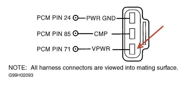

HMAC300
  • 48,601 POSTS
tis can be a couple of things, erase your code and unplug alternator if it goes out that is the problem. but also the cam sensor may be out of sync with cam and that can be a timing belt worn or the sensor out of sync measure voltage between battery ground and vpwr it's marked on pic. if that 's ok then you'll have to dig deeper or go to a pro.

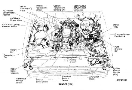

FLASHER44C
having trouble location cam shaft position sensor on my 97 ford ranger 2.3
Jun 30, 2020 at 5:59 PM (Merged)
DOCFIXIT
  • 18,828 POSTS
Left front engine behind P/S pump

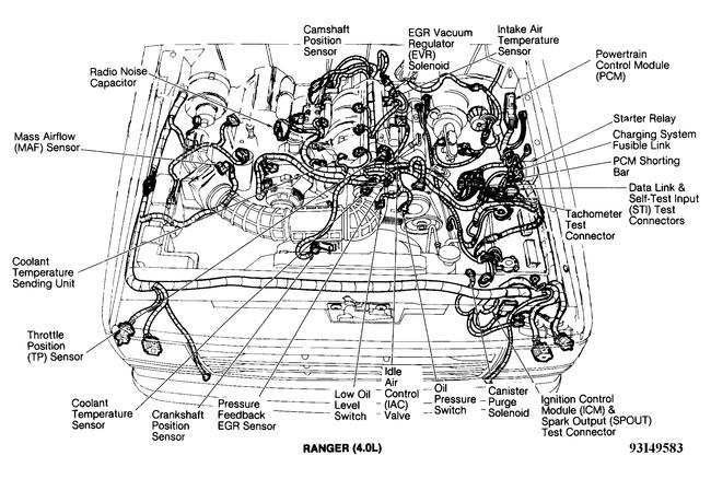

RYANVESTAL
Engine Mechanical problem
1994 Ford Ranger 4 cyl Two Wheel Drive Automatic
where is the camshaft position sensor on this vehical
Jun 30, 2020 at 6:08 PM (Merged)
BLUELIGHTNIN6
  • 16,542 POSTS
https://images.2carpros.com/forum/automotive_pictures/261618_Graphic_400.jpg
TONY C. M.
where is the cmp and ignition control module on a 1993 2.3 L  ford ranger xlt
DAVE H
  • 13,384 POSTS
hope this helps
https://images.2carpros.com/forum/automotive_pictures/266999_cam_2.jpg
