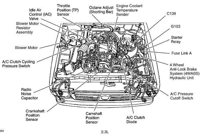

the temp guage on dash does not work,is this from the ect or iat.where is the ect?would this cause pinging going up hill,i use premium gas w octane booster pinging wont go away
Apr 4, 2019 at 6:36 AM (Merged)
HMAC300
  • 48,601 POSTS
no the pinging isn'tfrom using premium gas or booster, it can be from to much carbon on piston raising the compression to a bad ect to a lot of things. attached you'll find apic of ectlocationfor a 2.3L as you didnt' give engine size. the gauge could be bad though you have two ect's one for the gauge and one fo the pcm. on the ect gauge one groudn the woire and see if gauage goes up if it does then teh sender is bad if not it'sthe gague maybe

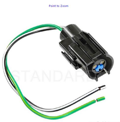

it's a two wire connector with a gry /yellow wire and blk/white wire the black white goes back to gauge. code s21 may be a bad ecm or poor connection for code 42 check fuel pressure key on engine off should be 30-45 psi if higher it may be pressure regulator or leaking injectors.

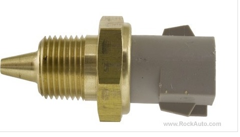

because the pressure drops right away try the fuel pressure regulator it shold keep pressure for at least 5-10 minutes before dropping. the temp sensor is supposed to be wired like I said the blak/wht wire goes back to gauge. so look for another wire and recheck the part. After looking at sensor I think you have the wrong sensor. I'm sending a pic of correc part, wired connector and location.

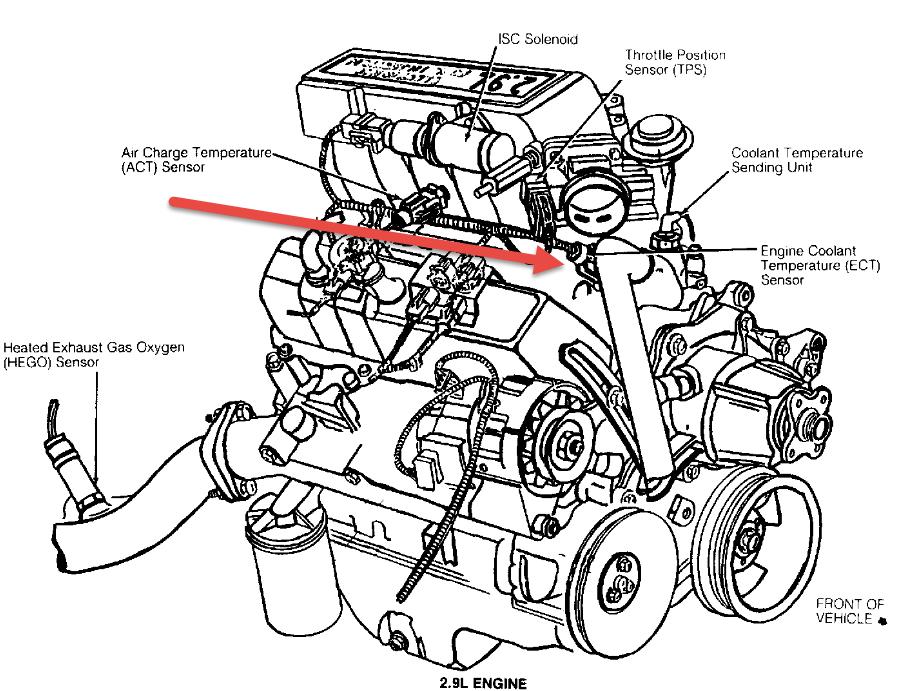

Your vehicle has a coolant temperature sensor as well as a coolant temperature sending unit. The sending unit is used for the gauge, the sensor used for the cooling fans. The sending unit for the 2.3L is on the left rear of engine, above the oil filter. For the 2.9L it is on the intake manifold, below the throttle body.

I still have the original problem of my temperature gauge not working. The pictures really help. (the best I have seen so far) I did find both, the coolant temperature sending unit and the ECT. I replaced the sending unit with no change on the gauge. I believe I already wrote this in a earlier post so I am sorry for repeating myself. I replaced this one based on a youtube video I saw. The video was based on a truck that was much older than mine. The truck in the video probably did not have an ECT or a computer for that matter. (No fuel injection.)
My confusion is based on the test from the video. I grounded the only wire that connects to the Coolant temperature sending unit, turned the key on and the temperature gauge inside the truck bottomed out on the hot side. In other words it moved. If nothing else is it safe to say that the gauge should work once I find the problem?
After I read your post and looked at the picture I pulled the ECT. I did an OMS test on it and I also check for resistance using hot water. The ECT tested positive. My guess now is a bad wire somewhere. I tried to do a voltage test on the ETC wires. With the key on I did get some voltage off of one wire. How do I test the other wire? (Sorry, I do not remember the colors because I did the test a few days ago) I would like to complete the test before I try to sort through all the wires.

the one wire that is getting voltage if grounded out will make the gauge go up to hot. if it'snot moving it may be the ground wire is the problem. I gave the color codes in one of the replies already so check the one going to the gauge. it can be a bad connection as well that is why I sent a pic of connector to temp sender. the code 21may be from the ect however so check connections at pcm and ect due to age of truck.

DAVE H
  • 13,383 POSTS
The "sender" inputs signal to the guage .. the sensor inputs signals to PCM and fans
Engine Coolant Temperature (ECT) Sender (2.3L)On left rear of engine, below oil pressure sender.
Engine Coolant Temperature (ECT) Sender (3.0L)On top right of engine, near thermostat housing.
Engine Coolant Temperature (ECT) Sender (4.0L)On top left front of engine.
Engine Coolant Temperature (ECT) Sensor (2.3L)On top right front of engine, in water outlet tube.
Engine Coolant Temperature (ECT) Sensor (3.0L)On top front of engine.
Engine Coolant Temperature (ECT) Sensor (4.0L)On top front of engine.
Apr 4, 2019 at 6:37 AM (Merged)
