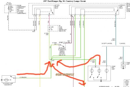

The dome/glove box light and windshield wipers won't work(or do intermittently) and the problem happens only when it is raining. The "bright" engineers at Ford put the 4WD circuit on the same circuit as the dome/glove box circuit so they also won't work. I think the wipers are on a different circuit so this really adds to my frustration. I have changed/swapped out the fuses
in the cab and engine compartments and even the wiper, wiper hi-lo relays in the engine compartment. I also changed the wiper motor. All to no avail. I suspect possibly an ignition switch problem or an in-dash relay problem because when the dome light and wipers finally kick in, I here an in-dash relay "click"
Please help.I am completely baffled by this problem

yes but I only have a partial "Mitchell" power distribution circuit diagram. It shows a 20A "parking
lamp" circuit which feeds the dome/glove box lights.
Something about a "generic electronic module" and a
"battery saver relay". Both in the circuit. No mention
of wipers anywhere. To add to the mystery, I'll pull over when the problem occurs and turn the parking lamps on and they work! Fleet mech. Where I work said he saw where 4WD circuit is tied in on his computer but due to proprietary issues, he couldn't give me rest of schematic. He also said it could be my ignition switch. Something in the ignition switch just controlling the wipers and dome/glovebox which kind of makes sense. Do you know where I could get a really good schematic for this truck and what do you think? Beginning to believe this one's for the ages.

Anyways...I looked at the diagrams and looked at the grounding. Different grounds.
I would look at splice 221, as you can see they are all tieing into this except the wipers. Therefore I would first pull the connector at the GEM and inspect it for corrosion os such and be keep an eye for potential wetness. If the connector looks good I would pull aprt the splice and get a good look at it.

LOL. Yeah, that sounded dumb.I really didnt word that right. From where you are, this must be like trying to change a plug on a mars rover. Anyway, I was able to spend some time on this yesterday. Your heading in right direction. I found out dont think rain has anything to do with this when I started to reason this out. Prob. Presents itself when wipers are on when its raining, otherwise I wouldnt see the
prob.(No need to turn inside lights on during day and no rain). So, I said to myself, "Self, lets just sit here in drivers seat of this thing with dome light and wipers on and see whats up.(Ignition in "off" pos.)" Lo and behold, about 5 min. Into my experiment, dome light turned off, wipers stopped, then started, then hesitated, then dome light turned back on again. (Kept hearing relay in dash clicking). Waited a while(still with ig. In off position) and when it happened again, I turned truck on(ignition "run" and the prob. Persisted for about 5 seconds then lights stayed on and wipers worked normally. I looked in manual about "battery saver" and it said the battery saver should shut interior lights
off after about 40 min. Guess what I'm trying to say is, would you think it could have something to do with the "Generic electronic module"(I think thats what controls the battery saver relay or a relay perhaps? Will do as you suggested, but what think?
