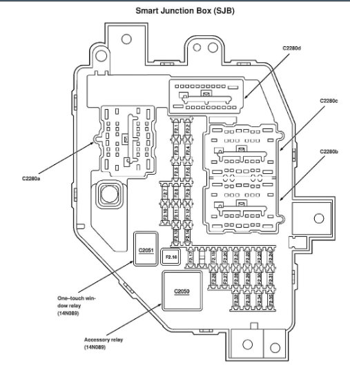

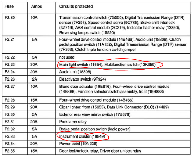

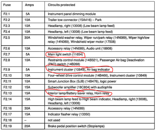

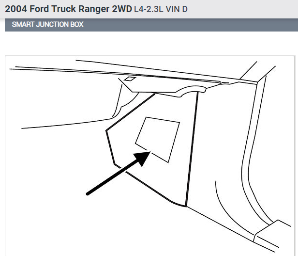

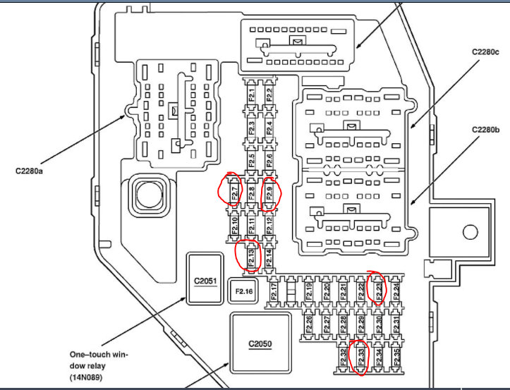

Here is the information you requested. The interior light fuses are located in the smart junction box in the lower right hand kick panel under the dash board. I've attached pictures below of its location and also circled in red the location of the fuses to check in the smart junction box for interior lighting. Here is a tutorial on how to check fuses:
