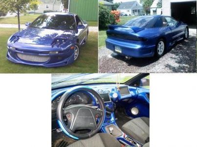

Hello i have a 93 ford probe gt v6 5 speed i love the car see i pressure washed the engine and now it wont start it turns over fine and wants to start but no spart it gets gas and everything.. i mean i didnt spray directly on the motor just over it like easy and i started it after and it started and ran for like a min then it started sputtering and stuff.. and now it wont start has no spark i replaced the distributor because it has the coil and everything built in i guess i replaced the the hole wiring harness and everything except the one that's under the hood that runs into the fuse box i replaced the crank sensor also why the hell wont it start!! ALSO! there is NO!!! CHECK ENGINE LIGHT ON!!
https://www.2carpros.com/forum/automotive_pictures/563170_COLLAJJE_1.jpg
