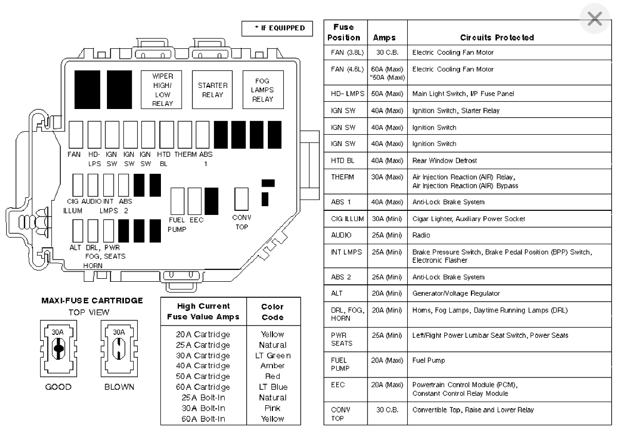

I would like to know which fuse operates the drivers seat motors I have just purchased a 1998 ford mustang thankk you for any help you can give me

The fuse for the power seat is located in the fuse box under the hood.
It should be a 25A fuse.

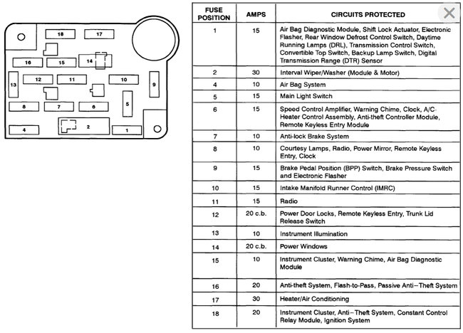

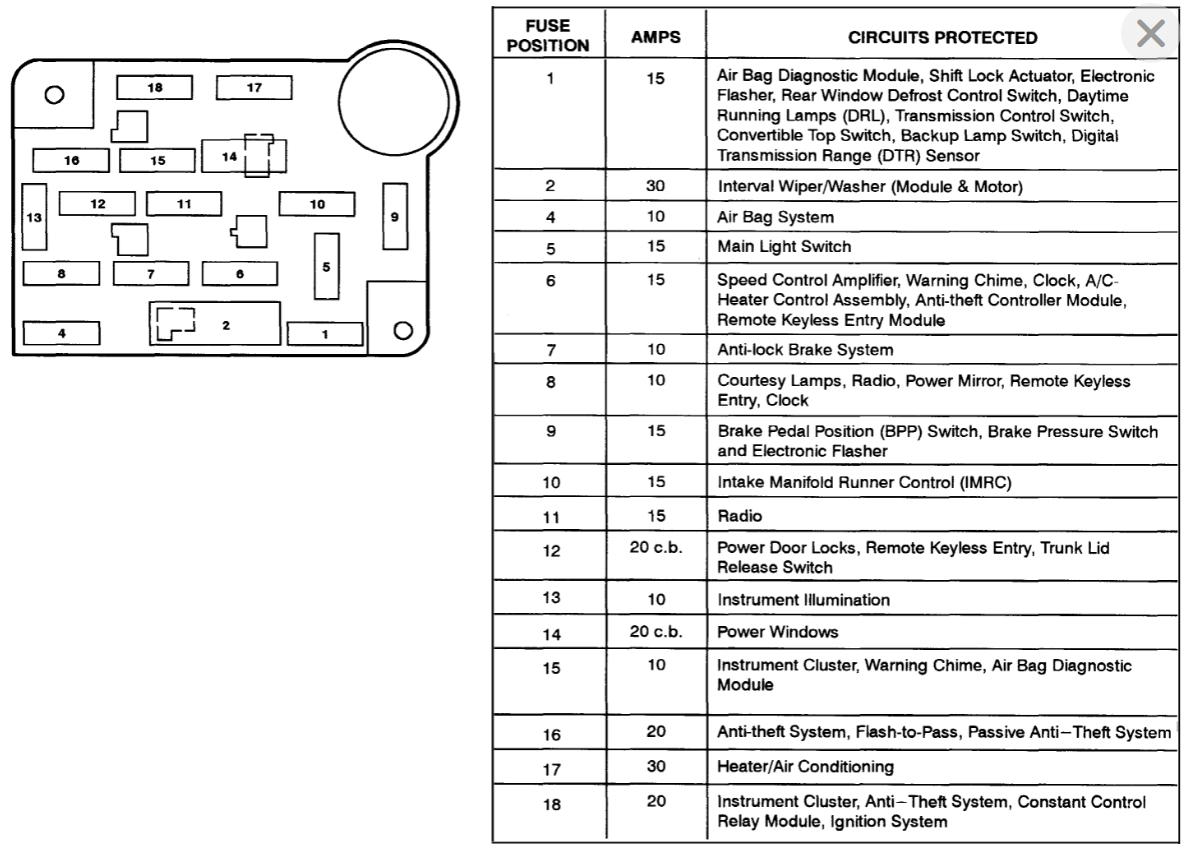

I have attached the fuse box diagrams below.
