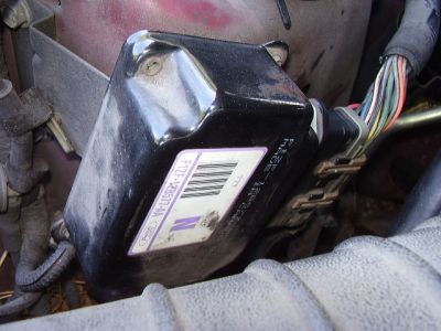

Today I had the spark plug wires and spark plugs replaced. Cost me $250.
The engine's still running very rough, but acceleration is better. RPM gauge shows 0. There are two dead wires.
Mechanic thinks its the ICM. Says they cost $300.
Is this thing hopeless?

This is what the mechanic is calling the ignition control module (ICM). I looked in my Haynes manual and don't see anything resembling this. It must be the problem, though.

SCARLET_STANG
  • 6 POSTS
He may not know this particular system well, he had to use a computer program to learn about it after I brought it in. But it's a prominent garage that been in business about 12 years.
First of all, the spark plug wires and plugs were so bad they would need to be replaced before any diagnostics could be done.
He told me at first he thought it was the coil, so he put in a new one and the problem persisted so that eliminated the coil from consideration.
The choices were then either a bad computer or bad ICM (the box in picture). We ruled out the computer since this box seemed to be affecting the performance of the engine when hit or pushed. Maybe a bad connection in the wire harness? So this box you call the CCRM, could it be the problem or should I keep looking?
