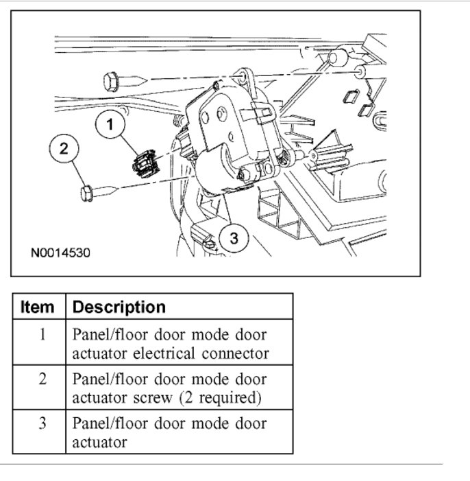

Air Conditioning problem V8 Two Wheel Drive Automatic 73000 miles
My air vents on the dashboard just stopped working. The foot vents blow,the defrost vents blow,the foot and defrost vents blow but when I turn the switch to blow on my face nothing comes out. The fan is blowing still on my feet. This is the same when A/C or heat is on. Yesterday it was working fine
Mar 31, 2009 at 4:14 PM
  • 54,840 POSTS
It sounds like you have a blend door actuator that has gone out that controls the mode. Here is a guide the give you an idea of what you are in for when doing the repair.
Here are some diagrams (below) of what it like on your car.
Please let us know what happens so it will help others.
