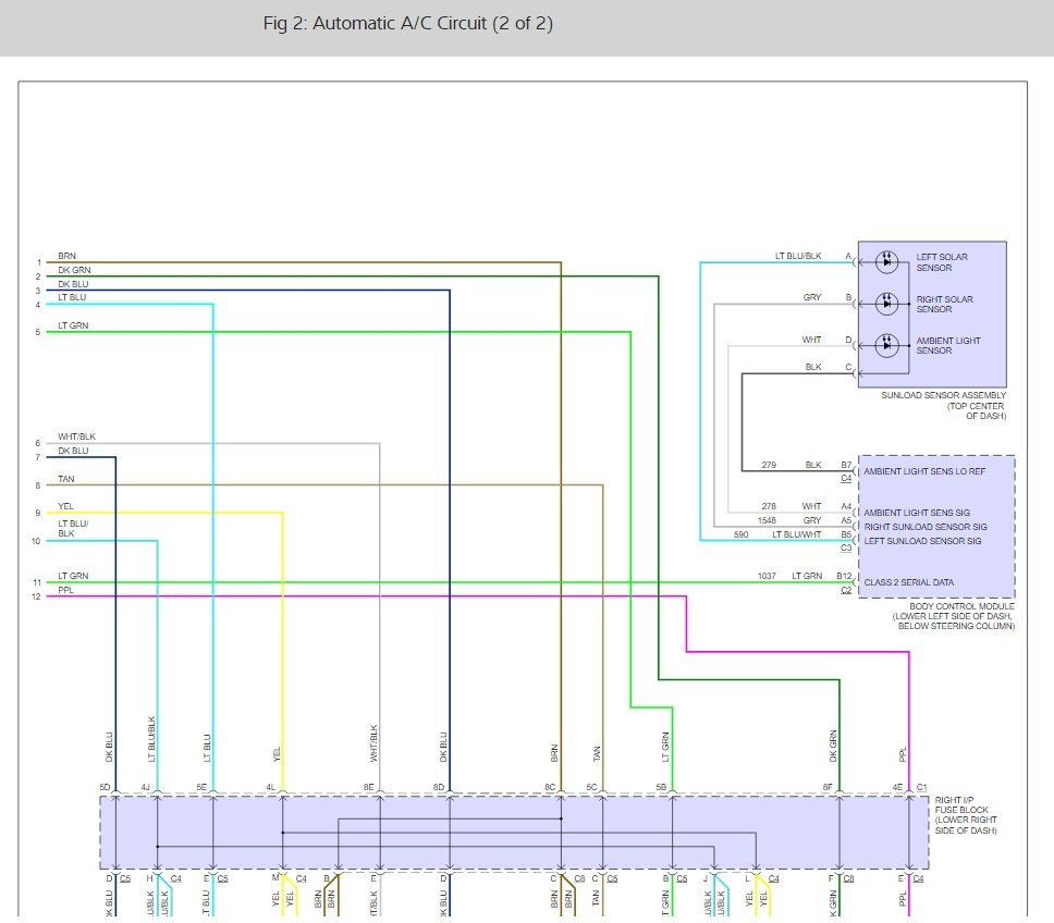

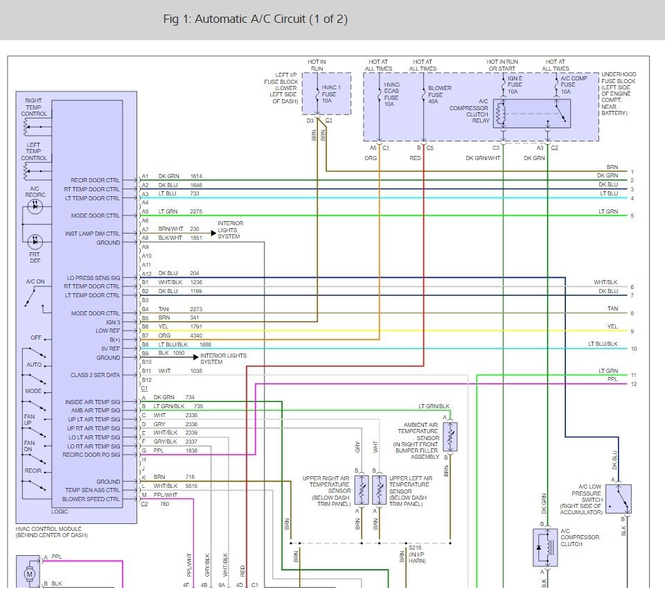

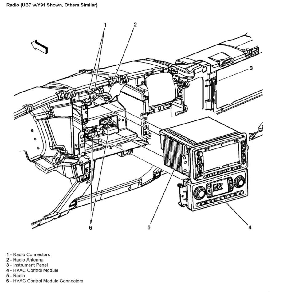

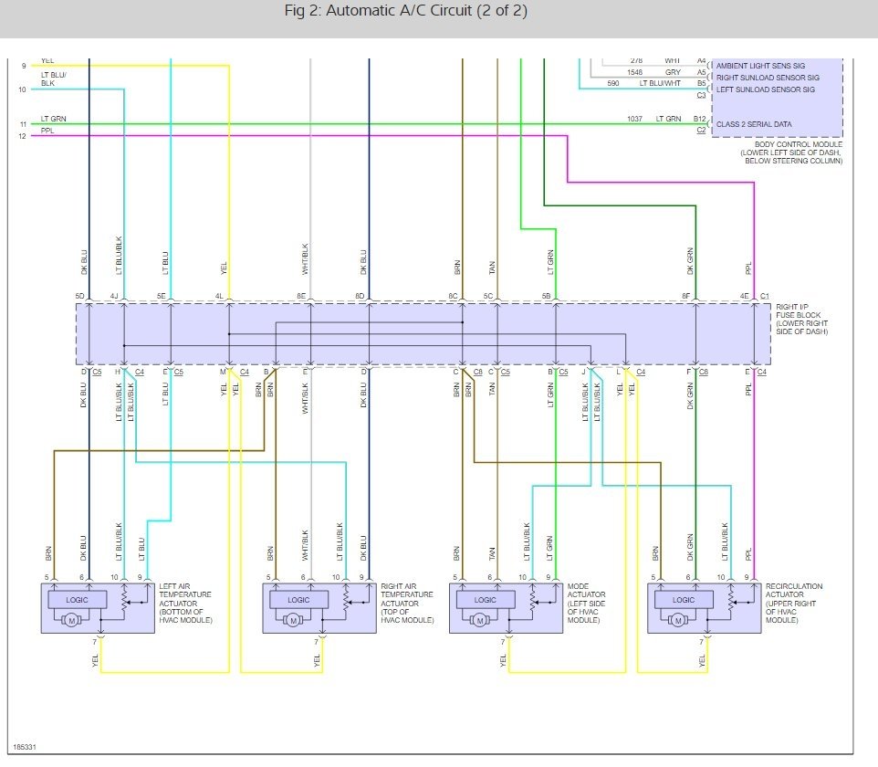

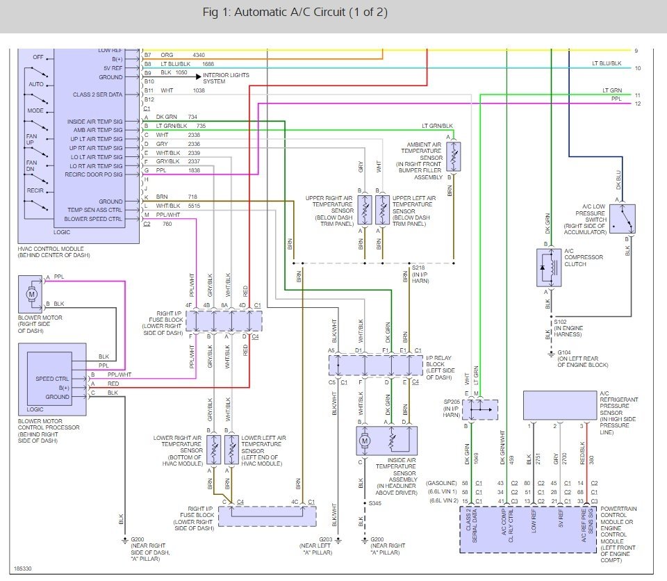

Hello again,
Here are the wiring diagrams (below) using in a 2004 chevy truck. You can see the power, command and actuator involvement.
Please let us know if you need anything else.
Jul 2, 2017 at 6:47 PM

Hello sir @2CARPROS KEN,
I am going through your wiring diagrams , first of all thanking for replying me with such detailed materials. but a little simple basic diagram would be helpful for me to first understand the basic concept of the connections and functions of each modules and then I can step up for the complex ones. Kindly send me some basic diagrams If you have some of them sir.
