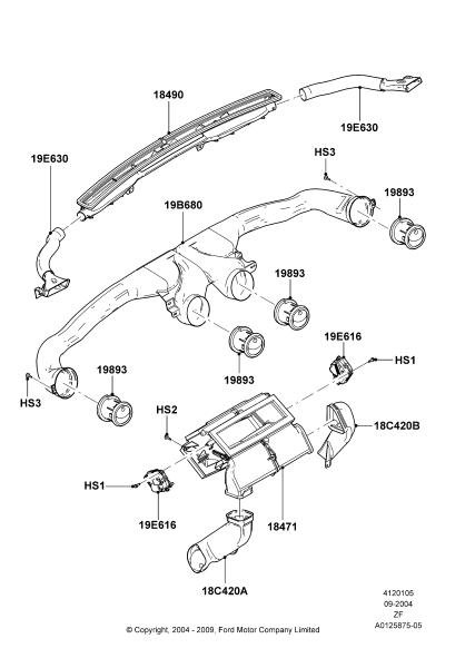

no cold air blowing at the front vent all the other vents work.

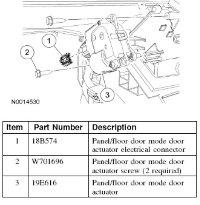

turned key to on powered up air conditioner set to max air conditioner unplugged floor/panel actuator several time, the third time it calibrated itself, and plows air out of front vents, fixed for now, someone has been to this actuator before, it is a used car to me. the plug no longer has the red safety clip on it.
Jul 17, 2016 at 11:41 AM
JOHN V KNOX
turned key to on powered up air conditioner set to max air conditioner unplugged floor/panel actuator several time, the third time it calibrated itself, and plows air out of front vents, fixed for now, someone has been to this actuator before. it is a used car to me, the plug no longer has the red safety clip on it. part your looking for will be left hand panel/floor 19E616. see image.

It may need to be scanned for codes if it happens again. it may have a bad connection on it.
