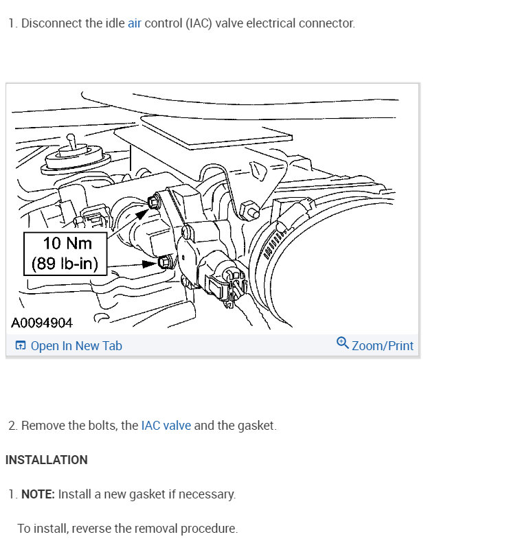

I've had some problems where if I was driving and turned on my AC, the car would stall when I slowed down. Usually only turn on the AC when on the freeway, not around town. Today, I was driving around town for about 20 minutes and the car heated up, it started stalling every time I slowed down. I knew it was time for an oil change, so I got one and they also noticed it had been overdue for a fuel filter, which I got replaced. Something they had not mentioned before, since I always go to the same place. After they changed the oil, they tried to start it up, and made "grinding" sound, so they let it sit a few more minutes and then started it again and it was fine. When I left, I wanted to see if the fuel filter was the problem, so I drove around for about 20 minutes and started doing the same thing, stalling when I was slowing down or at a complete stop. If this is just maybe bad spark plugs or something, I could take care of this myself, but the ford dealer told me they should be fine until 100K miles. Any help would be greatly appreciated.

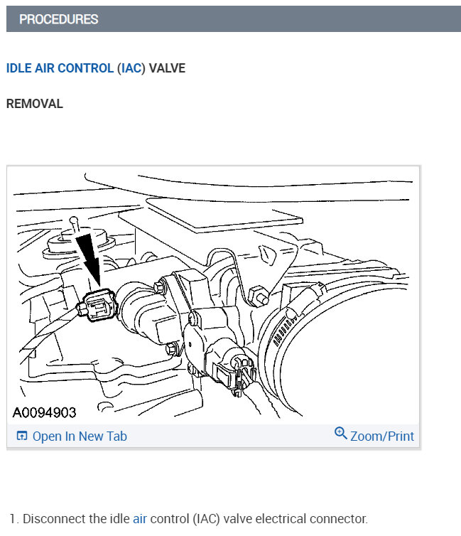

You may have a bad IAC ( idle air control) but try cleaning the throttle body first. Remove the intake snorkel, have someone hold the throttle wide open for you and scrub the back side of the throttle plate and surrounding bore with an old toothbrush and some carb cleaner. Be sure to spray some into the small holes next to the throttle plate. That should help stabilize the idle. If it still has a problem, replace the IAC. Check out the images (Below). Please let us know how it goes
