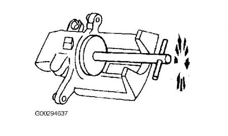

Hi. Trying to replace rear brake pads and the piston is stuck. Can't get it to push all the way in. Using C-Clamp and WD40 to losen case, but is still not working. Any suggestions?
Thanks!

It isn't seized, and you may have ruined the caliper.
https://images.2carpros.com/forum/automotive_pictures/30961_cali_1.jpg
The piston needs to be turned while being compressed. The best way is to get a special tool for that, although it can be done otherwise....but a real pain.
