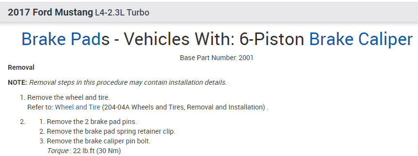

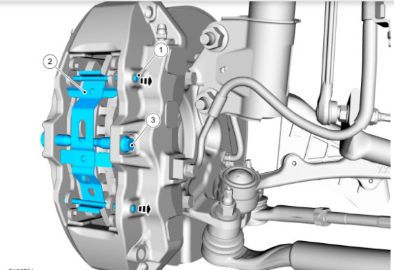

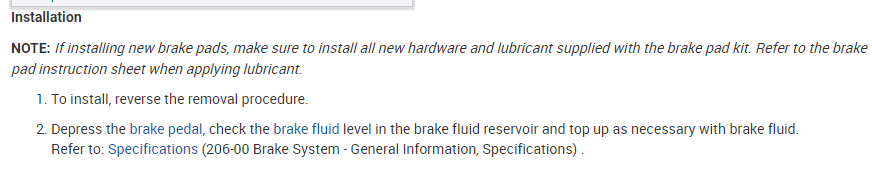

Hello. When I release slowly from the brake pedal while stopping at low speeds, it makes the spring-kind noise from the pedal. It is somewhat faint but it comes on and off. The dealership thought the noise was from brake switch but even after replacing that, the noise is still there. The sound is kind of different from clanking or squealing sound but so I checked it out I need front brakes please help me do the job.
Mar 26, 2017 at 3:59 PM
DANNY L
  • 5,648 POSTS

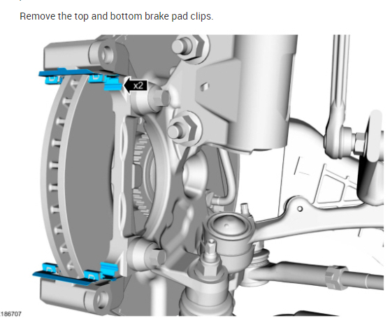

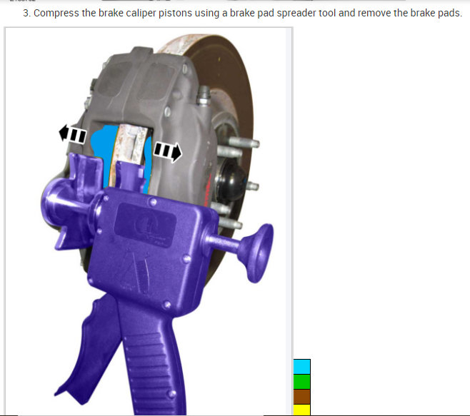

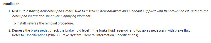

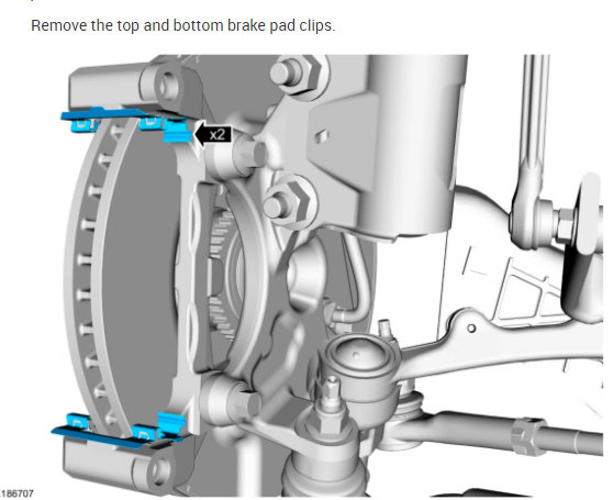

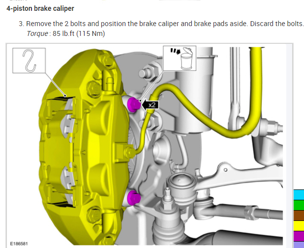

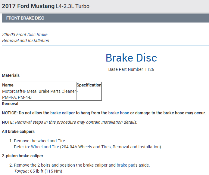

Hello, I'm Danny.

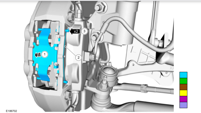

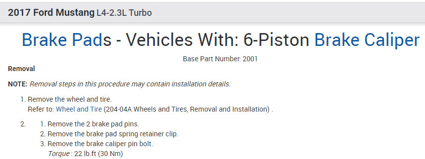

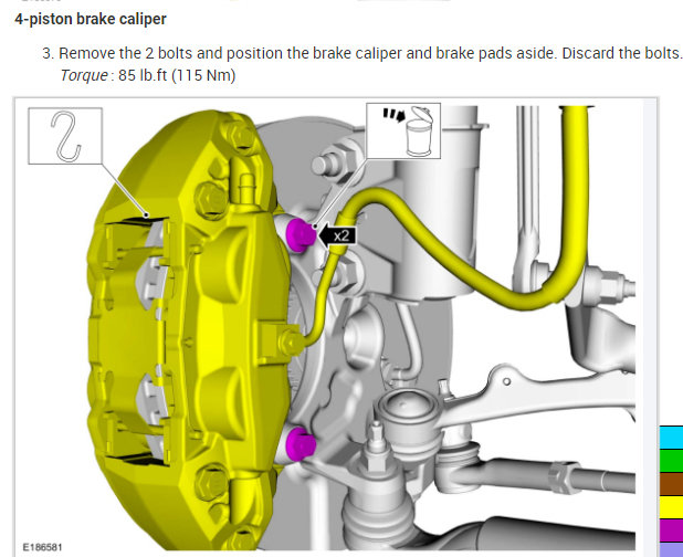

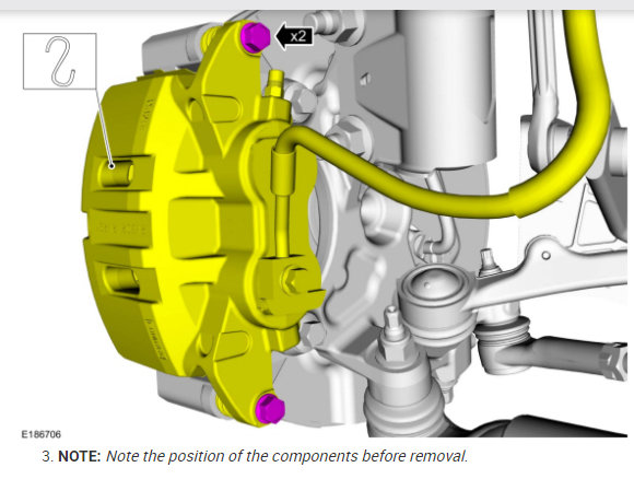

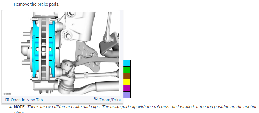

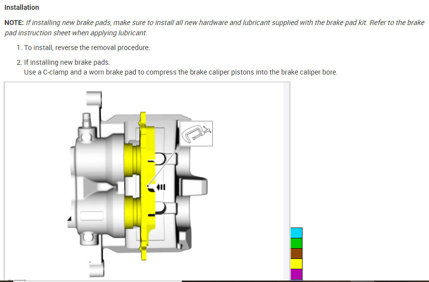

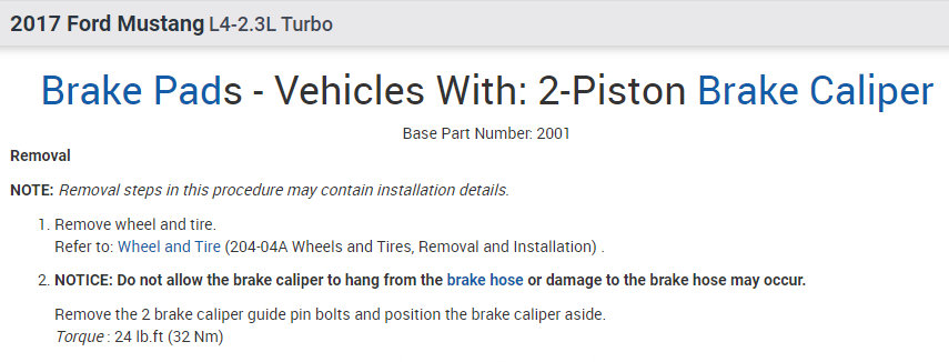

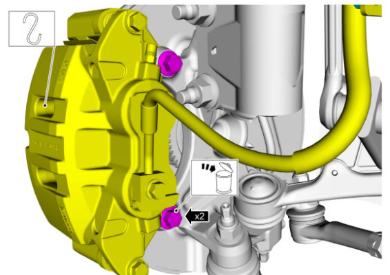

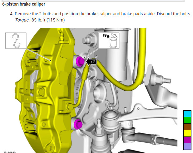

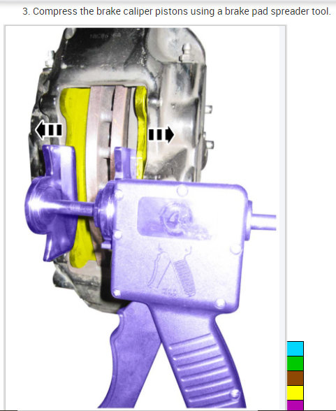

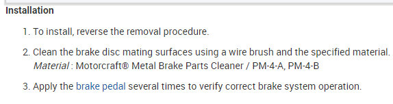

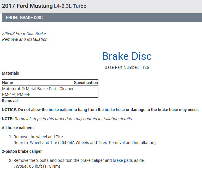

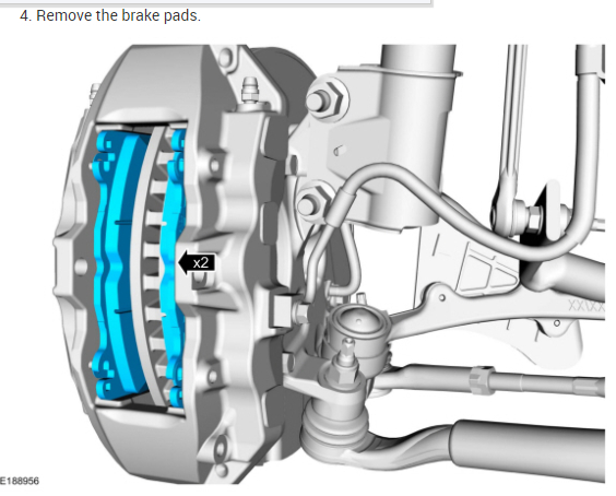

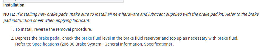

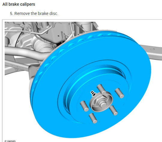

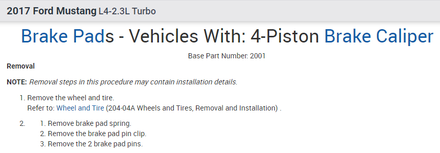

Here is the information you requested. This is a tutorial showing what is involved on how to change front brake pads and brake rotors:
I've attached picture steps below on how to change the front brake pads and rotors on your car. I've included the steps for the 2, 4, and 6 piston brake calipers available on your car. Hope this helps and thanks for using 2CarPros.
