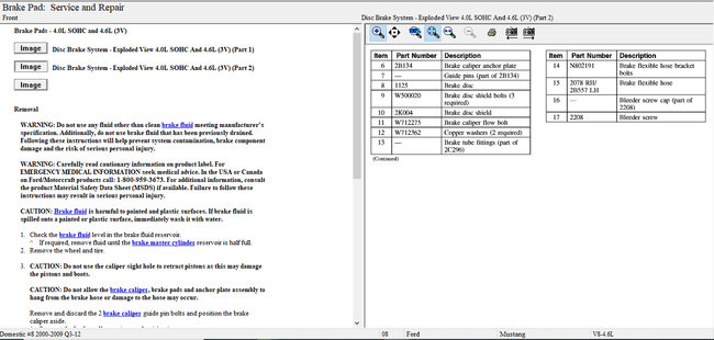

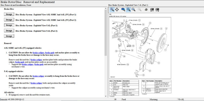

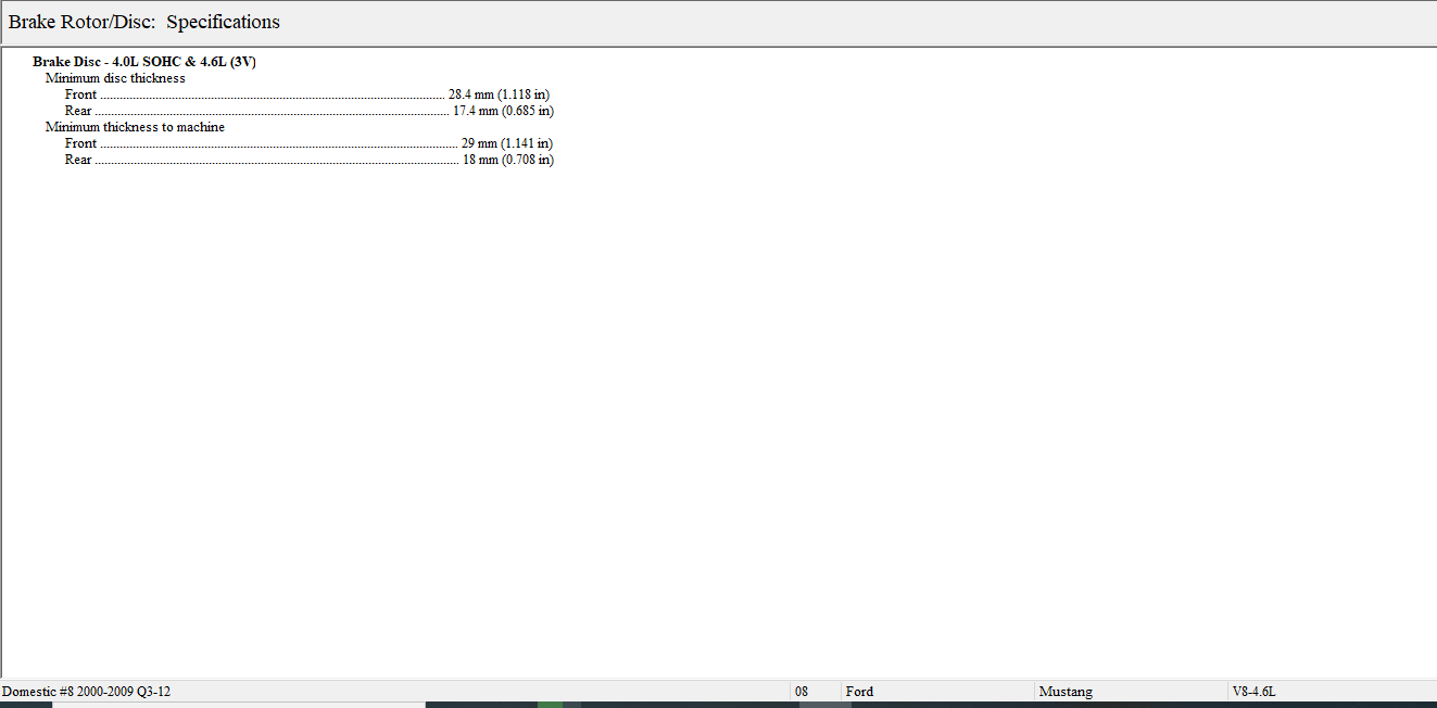

i have a 08 mustang gt. the car will shake when stopping can you help??
Feb 13, 2009 at 6:15 PM
SEVAG P
  • 405 POSTS
hello.

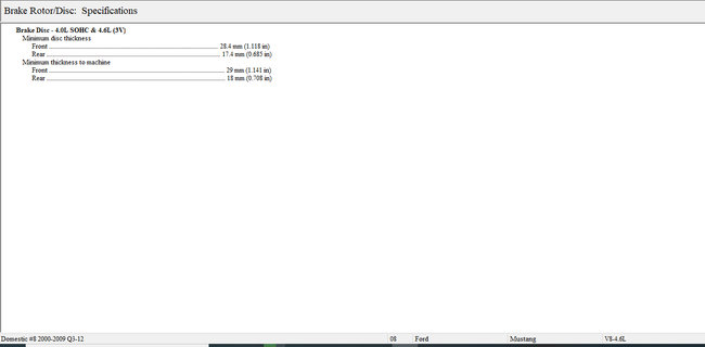

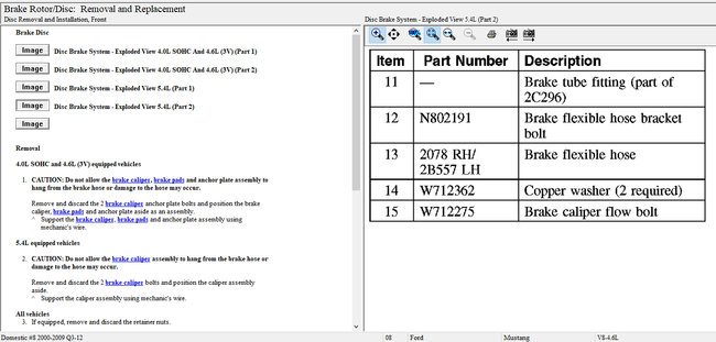

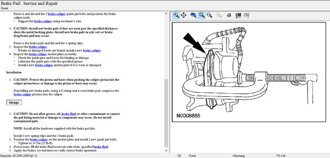

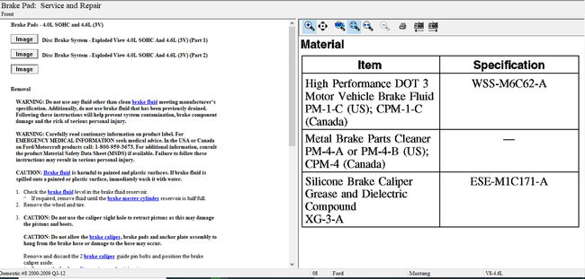

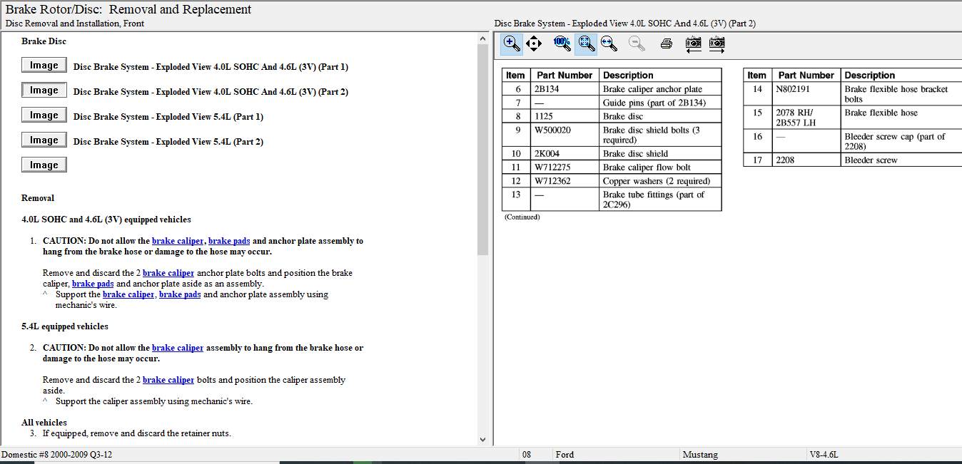

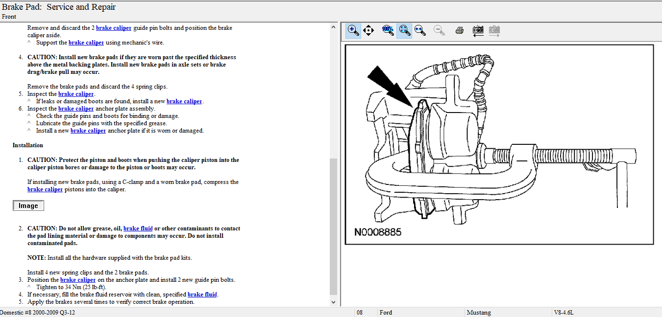

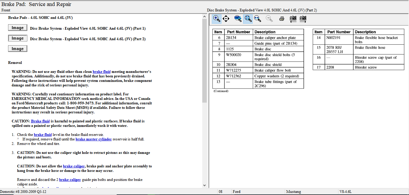

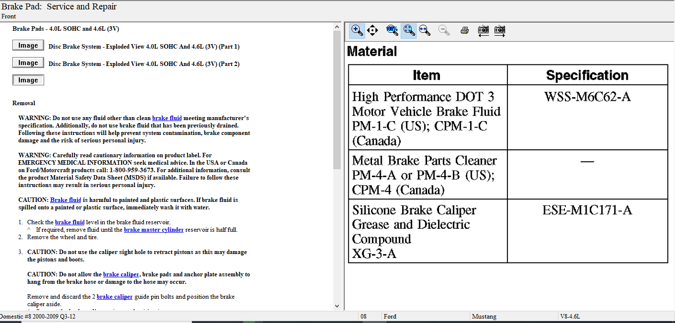

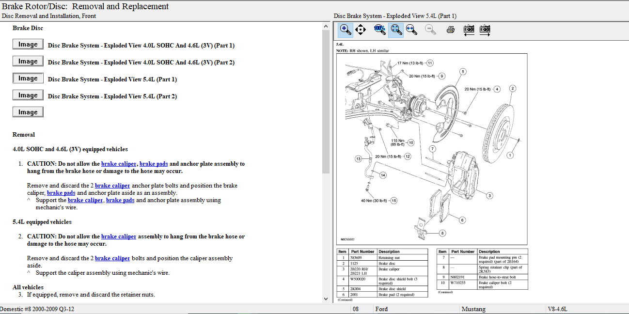

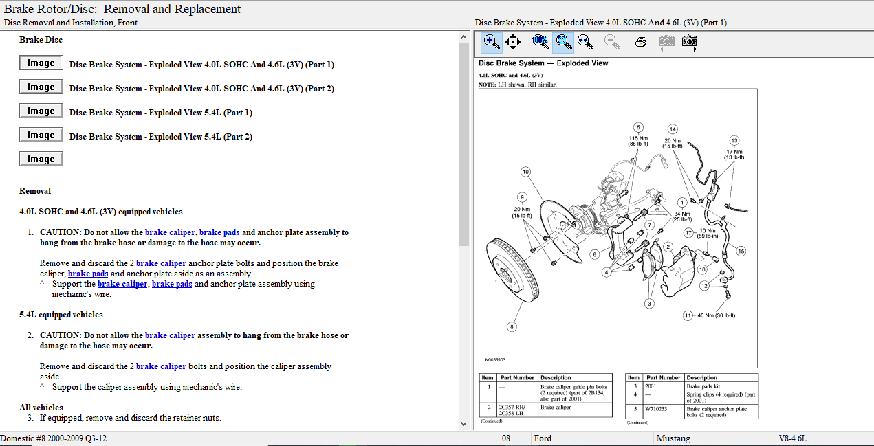

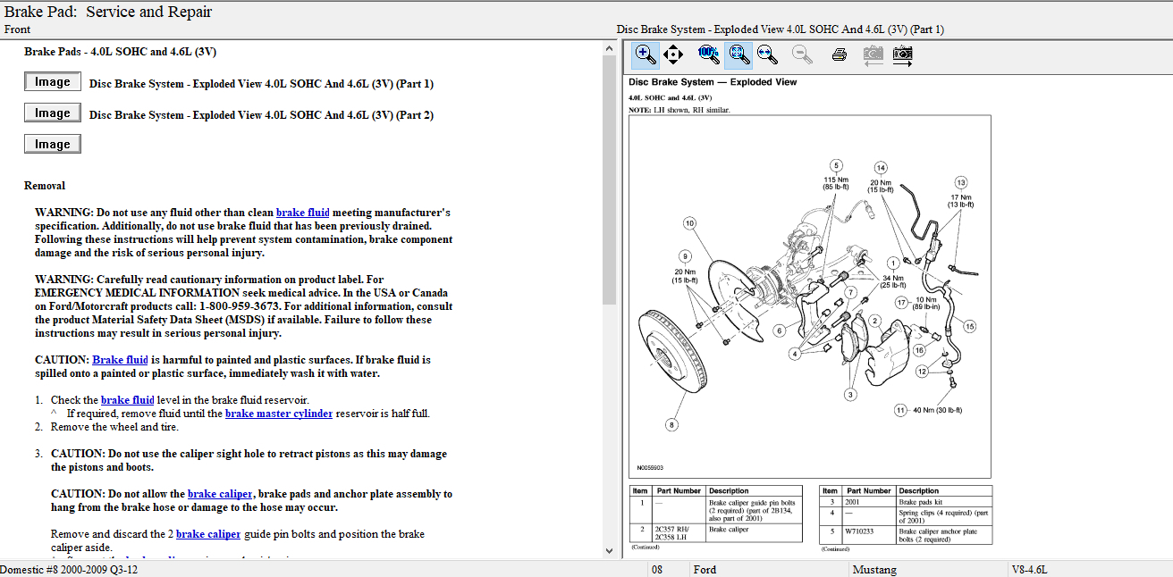

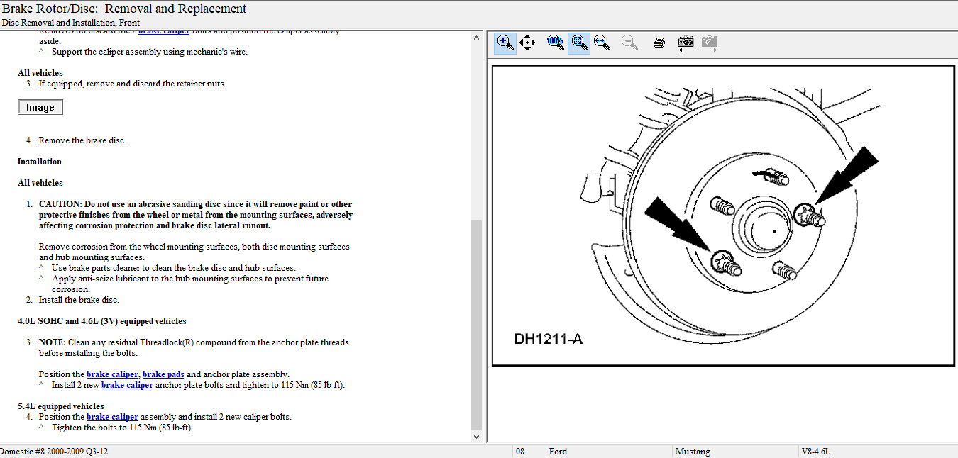

If the car and the brake pedal vibrates when braking that means front rotor defected has excessive lateral run out, front rotor and pads must be replaced.
check our guide below how to replace pads and rotors.
Check the diagrams below how to replace brake pads and discs.
hope these helps .
