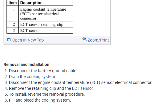

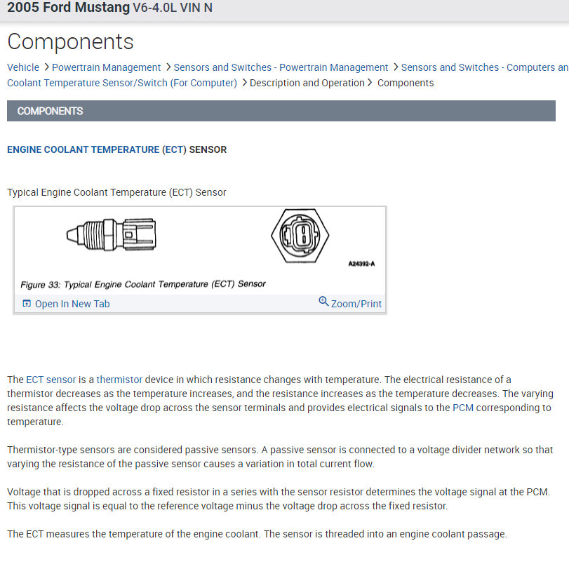

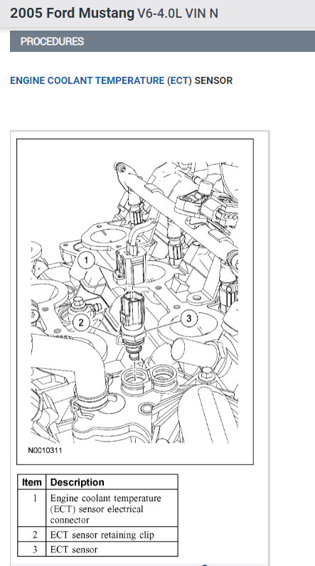

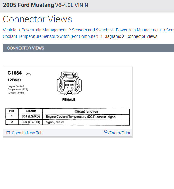

My engine temp gauge does not seem to work where is the sender?
Jul 21, 2010 at 11:35 PM
SQM
  • 6,383 POSTS
The coolant temperature sensor is located on the top front part of the engine, next to the thermostat housing.
https://www.2carpros.com/articles/symptoms-of-a-bad-coolant-temperature-sensor
https://www.2carpros.com/articles/coolant-temperature-sensor-cts-replacement
