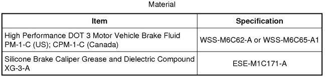

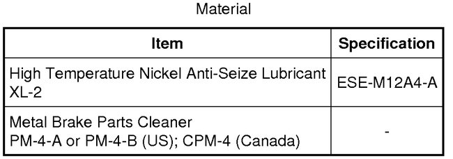

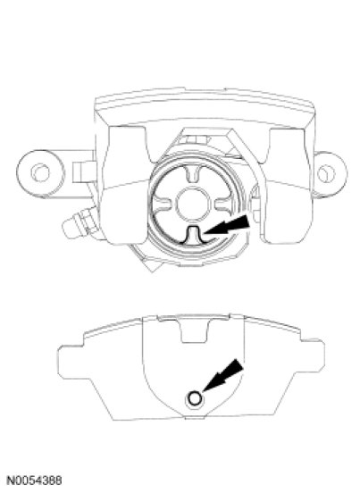

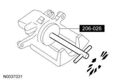

Here are the directions specific to your vehicle. The attached pics correlate with the directions.
____________________________________________
2010 Ford Mustang V6-4.0L
Brake Pads
Vehicle Brakes and Traction Control Disc Brake System Brake Pad Service and Repair Removal and Replacement Rear Disc Brake Brake Pads
BRAKE PADS
Brake Pads
pic 1
pic 2
Removal
WARNING: Do not use any fluid other than clean brake fluid meeting manufacturer's specification. Additionally, do not use brake fluid that has been previously drained. Following these instructions will help prevent system contamination, brake component damage and the risk of serious personal injury.
WARNING: Carefully read cautionary information on product label. For EMERGENCY MEDICAL INFORMATION seek medical advice. In the USA or Canada on Ford/Motorcraft products call: 1-800-959-3673. For additional information, consult the product Material Safety Data Sheet (MSDS) if available. Failure to follow these instructions may result in serious personal injury.
WARNING: Always install new brake shoes or pads at both ends of an axle to reduce the possibility of brakes pulling vehicle to one side. Failure to follow this instruction may result in uneven braking and serious personal injury.
NOTICE: Do not spill brake fluid on painted or plastic surfaces or damage to the surface may occur. If brake fluid is spilled onto a painted or plastic surface, immediately wash the surface with water.

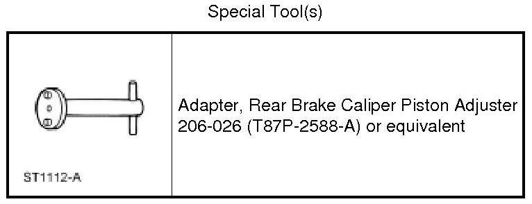

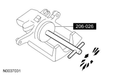

1. Using the Rear Brake Caliper Piston Adjuster Adapter, compress the brake caliper piston into the brake caliper bore.
pic 3

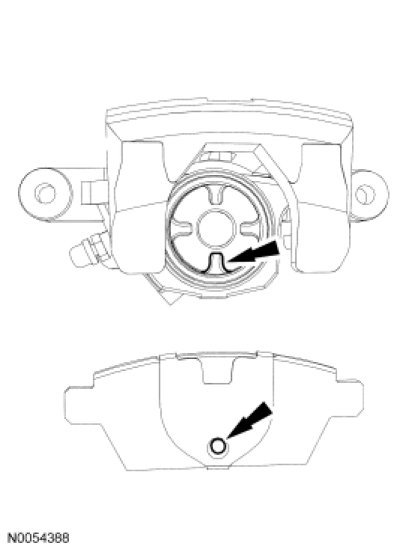

2. Position the notch in the caliper piston up and down to align with the alignment pin on the brake pad.
3. NOTICE: Do not allow grease, oil, brake fluid or other contaminants to contact the pad lining material, or damage to components may occur. Do not install contaminated pads.
NOTE: Install all hardware supplied with the pad kit.
Install the 2 new spring clips and the brake pads.
pic 4

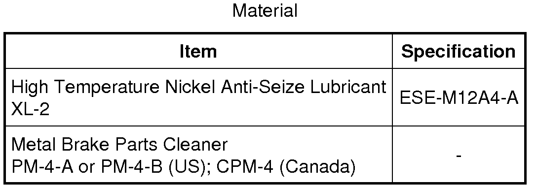

Rotor Replacement
Brake Disc
Vehicle Brakes and Traction Control Disc Brake System Brake Rotor/Disc Service and Repair Removal and Replacement Rear Disc Brake Brake Disc
BRAKE DISC
Brake Disc
pic 5
Removal
1. Remove the wheel and tire. For additional information, refer to Wheels and Tires.
2. NOTICE: Care must be used when servicing rear brake components without disconnecting the parking brake cable from the brake caliper lever. Carefully position the caliper aside using a suitable support or damage to the parking brake cable end fittings may occur.
NOTICE: Do not allow the brake caliper and anchor plate assembly to hang from the brake hose or damage to the hose may occur.
Remove and discard the 2 anchor plate bolts and position the brake caliper anchor plate and brake caliper assembly aside.
- Support the caliper using mechanic's wire.
3. Remove the brake disc.
Installation
1. Clean any rust or foreign material from the brake disc and the wheel hub.
- Use the specified brake parts cleaner to clean the brake disc and hub surfaces.
2. NOTICE: In order for the brake caliper anchor plate bolts to attain the proper clamp load when installed, the residual threadlock compound must be cleaned out of the bolt threads of the anchor plate.
Clean any residual threadlock compound, and any other foreign material, from the threads of the brake caliper anchor plate.
3. NOTICE: Do not allow the lubricant to make contact with the wheel studs, brake pads or brake disc or damage to components may occur.
Apply a thin coat of the specified anti-seize lubricant to the hub flange.
4. Position the brake disc onto the wheel hub.
5. Position the brake caliper anchor plate and install 2 new anchor plate bolts.
- Tighten to 103 Nm (76 lb-ft).
6. Install the wheel and tire. For additional information, refer to Wheels and Tires.
- Apply brakes several times to verify correct brake operation.
