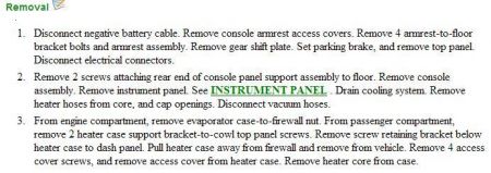

Does the ac dryer have to be removed and ac freon removed to put the heater core in

Hi there, reading Mitchell 1 it looks as if you don't have to, I am having a problem copying the section, so I will sent it when I get this small problem sorted.

I am still waiting for a answer on my heater core install on 95 gt v8 mustang thanks rick h.

Hi there, sorry about the delay i had a problem with my PC i hope this helps.
