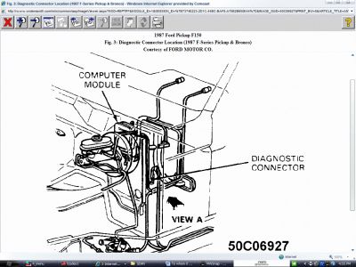

Where do I find the "pigtail" to dump the Rear antilock Brake trouble codes for a 1987 F-150 XLT Lariat with a 302 V-8, auto trans, and approximately 126,000 miles. This truck apparently uses Fords RABS I system and all the information I can find is for the Ford RABS II system.

To read the codes Momentarily ground the connector with the key on then count the flashes...don't turn off the key or you will lose the codes!
https://images.2carpros.com/forum/automotive_pictures/62217_87Rabs_1.jpg
https://images.2carpros.com/forum/automotive_pictures/62217_30961_mitchell_2_54.jpg

With the key on, momentarily ground the RABS diagnostic connector and count the flashes. Do not turn the key off or the codes will be lost. Use the attached diagrams to locate the connector.
