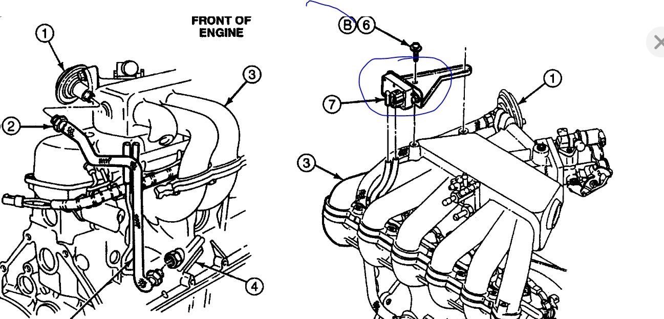

I have a 96 F-150. 4.9L inline six engine. My check engine light came on. Trouble codes read 171(System too lean bank 1) 174 (System too lean bank 2) and 401 (EGR flow insufficient). Where is a good place to start? Truck seems to run sluggish and sometimes after stopping from high speed on the highway it will stall. Any help will be great.

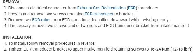

The 401 is for the DPFE sensor. Very common failure. When you replace it, make sure the lines are replaced as well.
