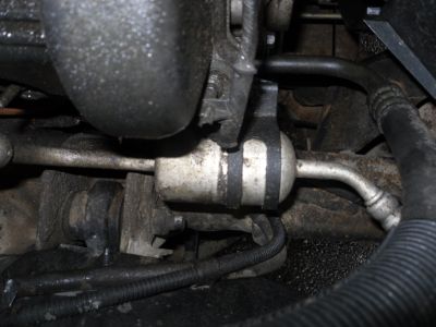

I did however lissten more for the rattle noise. Using a wooden dowel I tried more places to narrow down the origin. The most distinctive sound that matched the adable sound seemed to come from a canaster connected to the radiator with metel hoses (it looked like a filter, but am unable to find any parts matching or pictures) it is located on the right side down near the wheel well.

I'm glad to help, but we haven't fixed it yet. As far as the part you mentioned, it sounds like the charcoal canister for the emissions system. I have a 99 and just walked out and looked. The only canister on either side of the radiator is the over flow on the driver's side and nothing on the passanger side. If you can take a picture of yours and upload it for me to see, it would be helpful.

I got a picture of what i mentioned It sets level with the tensioner just below the right side valve cover.
It doesent seem like this could make that kinda noise, but like I said when I listened to different parts thru a dowel that gave me the most prevelent sound. Audibly you here it the most destinctive from under the front right.

No luck with the pic. upload page. it says "Web site cannot display this page. Page maybe under construction." after I try to upload.
https://www.2carpros.com/forum/automotive_pictures/499043_SDC10082_1.jpg

It think that is an AC component. Does it run to the other side of the radiator?

Yes actually it runs to between the radiator and grill. (For the life of me I cant think or the name) then under the engine block, but I loose it from there.
When I was first looking at it I thought maybe something to do with cooling the oil.

As far as the part in pic. That would have anything to do with the fuel pressure regulator or fuel charging would it?
