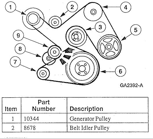

DENNES_D
  • 1990 FORD F-150
I need to find the diagram for the serpentine belt on a 1990 Ford F-150 V8 5.0 & A/C. Diagram is not under hood or near radiator. Does anyone know where I can find one?
Thanks
Thursday, July 16th, 2020 AT 11:32 AM (Merged)
FAIRRACING31
  • 150 POSTS
https://www.2carpros.com/forum/automotive_pictures/103836_Belt_1.jpg
+5
DENNES_D
Thanks for the help and for the quick response!
