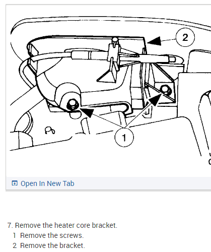

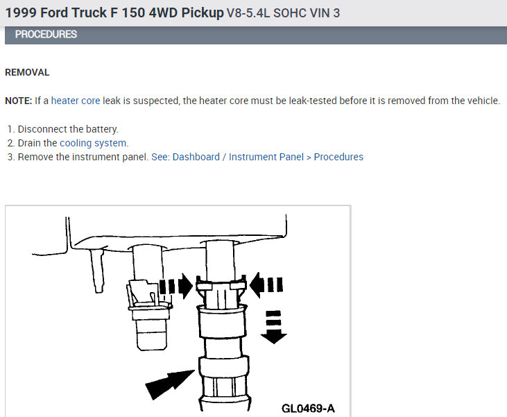

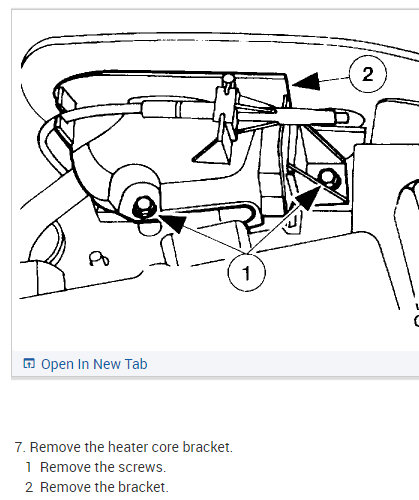

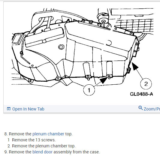

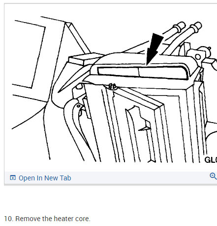

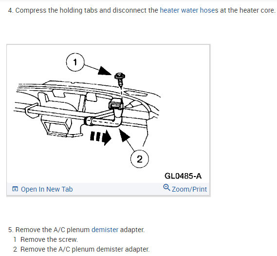

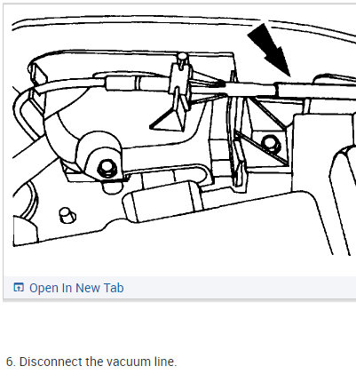

I am having trouble getting to the heater core in my truck. Do I have to take the whole dash out to complete the job?

Hello, I'm Danny.
Just to add more content I've attached picture steps below. Here is a tutorial showing how to replace a heater core:
https://www.2carpros.com/articles/replace-heater-core
Below I've attached the picture replacement steps for your truck. Hope this helps and thanks for using 2CarPros.
