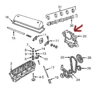

I haven't found anything worthwhile yet for a better pic. Things I would do is use good lighting, compressed air blower to blow away coolant to see it return, a small mirror. You may need to remove some things to get a better view. Don't forget about a rotted freeze plug or the water pump by pass hose. Look carefuly at the timing cover gasket. I think the coolant erodes away some of the cover on them.
https://images.2carpros.com/forum/automotive_pictures/30961_tc_1.jpg

AS I was reading your post, the first instinct that I had was the timing cover/gasket. They are notorious for leaking between the cover and the block. Then the coolant runs down the edge of the oil pan and onto the front undercarraige. From there it goes everywhere. I would agree with Servicewriters last post. Check teh front cover and gasket. You may want to prepare yourself for a fight getting it off also. The long bolts that go through the pump and cover can break.
