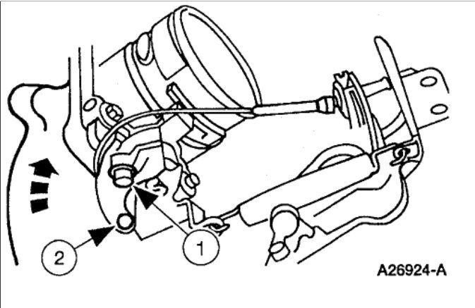

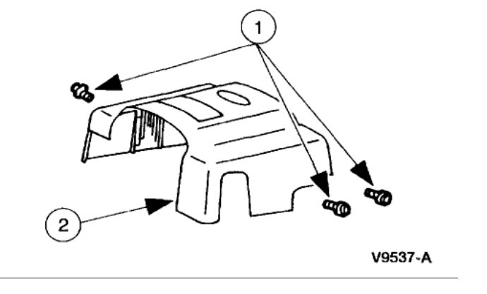

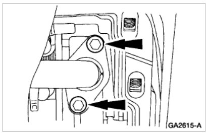

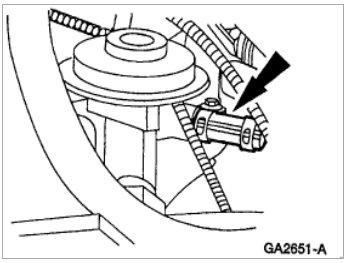

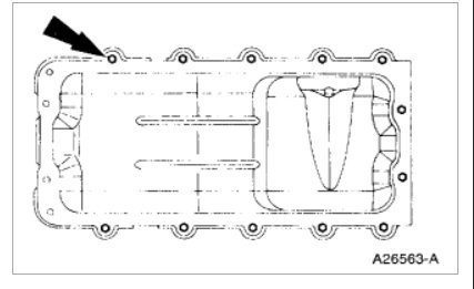

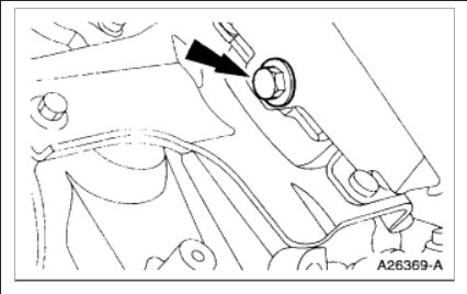

How do I remove the oil pan in my 2002 Ford F-150 V6 4.2 Liter. I need your help can you please give me instructions and step by step diagrams please? I love this site.
THANKS!
Jan 18, 2007 at 10:15 PM
  • 54,840 POSTS
You must raise the engine up to get the pan out. Here is a safe way to raise the truck
The best way is to jack up the engine so that you can unbolt it from the bottom and have enough room between the engine block and the crossmember to remove it.
Disconnect the exhaust, unbolt the engine mounts, unbolt (or at least loosen and back off) the transmission mounting nuts, unbolt the fan shroud and drape it over the fan, (can't really get it out unless you remove the fan as well) and then some models require you to remove a few components on top of the engine so that you are able to jack the engine up the necessary five or six inches to clear the crossmember.
You can then unbolt the oil pan, reach in, unbolt the oil pump and pickup tube, drop those into the pan and haul the pan out of there. I hope this helps.
Don't forget to drain the oil beforehand.
Here are some guides from the repair manual (below)

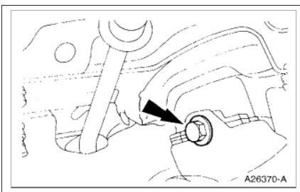

Hi there, See text for sump removal. mark (mhpautos)
https://images.2carpros.com/forum/automotive_pictures/61395_1_35.jpg

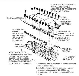

Hi there, oil pan R&R instructions. mark (mhpautos)
https://images.2carpros.com/forum/automotive_pictures/61395_Capture_13.jpg

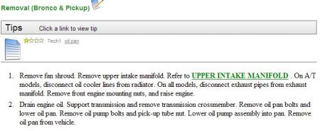

OIL PAN
Removal
Remove fan shroud.
Remove upper intake manifold.
Remove front engine mount-to-frame nuts and raise engine.
On A/T models, disconnect oil cooler lines from radiator.
Disconnect exhaust pipes from exhaust manifold.
Drain engine oil.
Support transmission and remove transmission crossmember. Remove oil pan bolts and lower oil pan.
Remove oil pump bolts and pick-up tube nut.
Lower oil pump assembly into pan.
Remove oil pan from vehicle.
Installation
To install, reverse removal procedure. Apply silicone sealant at front and rear corners of oil pan surface and cylinder block, and where timing chain cover meets cylinder block. To install remaining components, reverse removal procedure.

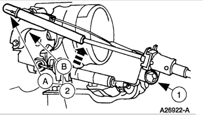

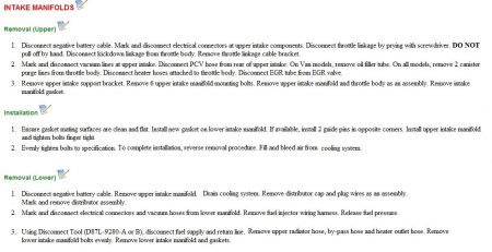

BLUELIGHTNIN6

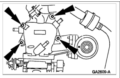

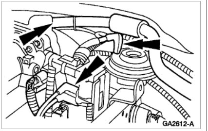

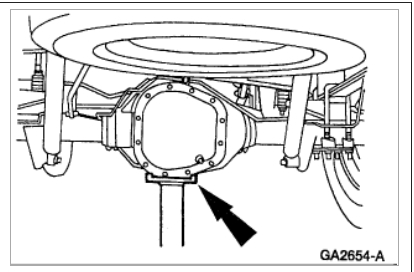

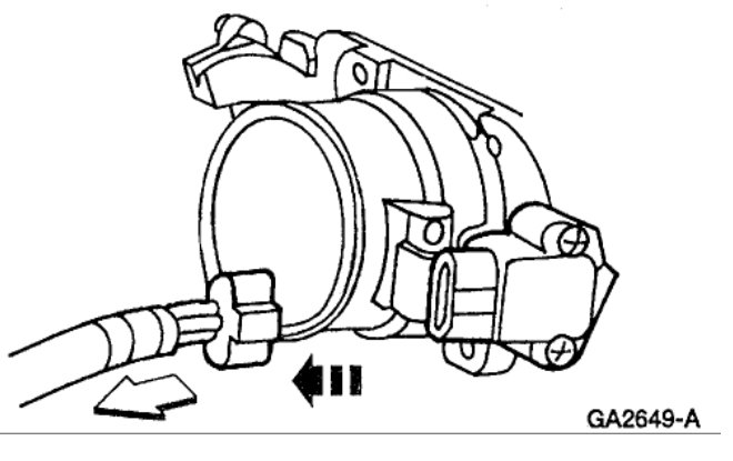

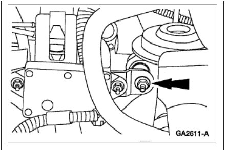

  • 16,542 POSTS
https://images.2carpros.com/forum/automotive_pictures/261618_Noname_1866.jpg
https://images.2carpros.com/forum/automotive_pictures/261618_Noname2_593.jpg
https://images.2carpros.com/forum/automotive_pictures/261618_Noname3_231.jpg

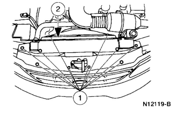

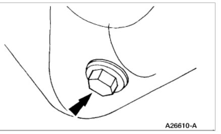

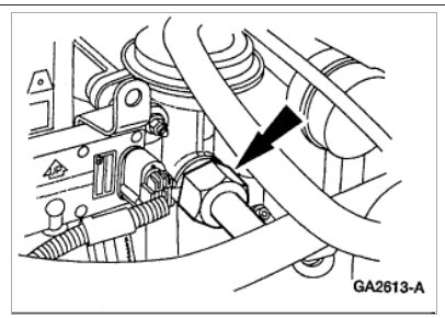

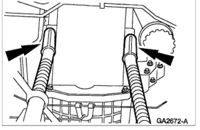

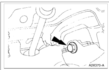

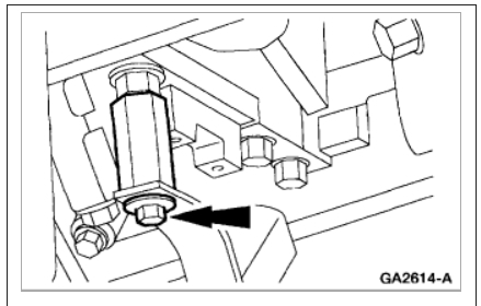

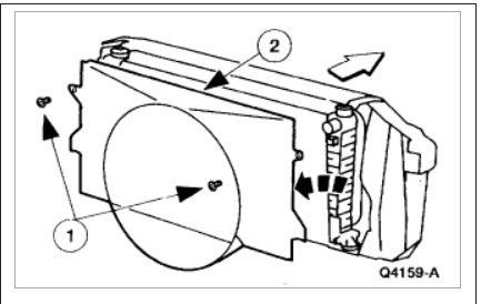

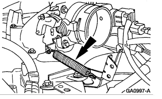

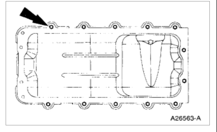

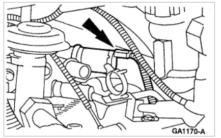

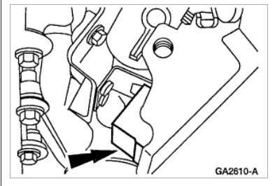

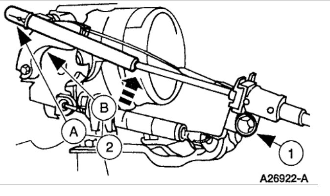

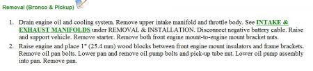

Yes, you will have to lift engine. Here is step by step how to replace oil pan.
https://images.2carpros.com/forum/automotive_pictures/307763_Noname_26.jpg
1.Drain the crankcase. CAUTION The EPA warns that prolonged contact with used engine oil may cause a number of skin disorders, including cancer! You should make every effort to minimize your exposure to used engine oil. Protective gloves should be worn when changing the oil. Wash your hands and any other exposed skin areas as soon as possible after exposure to used engine oil. Soap and water, or waterless hand cleaner should be used. 2.Drain the cooling system. CAUTION When draining the coolant, keep in mind that cats and dogs are attracted by ethylene glycol antifreeze and are quite likely to drink any that is left in an uncovered container or in puddles on the ground. This will prove fatal in sufficient quantity. Always drain the coolant into a sealable container. Coolant should be reused unless it is contaminated or several years old. 3.On 1987-93 models, remove the upper intake manifold and throttle body (see Fuel System ). 4.Remove the starter. 5.Remove the engine front support insulator to support bracket nuts and washers on both supports. Raise the front of the engine with a transmission jack and wood block and place 1 in. (25mm) thick wood blocks between the front support insulators and support brackets. Lower the engine and remove the transmission jack. 6.Remove the oil pan attaching bolts and lower the pan to the crossmember. Remove the two oil pump inlet tube and screw assembly bolts and drop the assembly in the pan. Remove the oil pan. Remove the oil pump inlet tube attaching bolts. Remove the inlet tube and screen assembly from the oil pump and leave it in the bottom of the oil pan. Remove the oil pan gaskets. Remove the inlet tube and screen from the oil pan. To install: 7.Clean the gasket surfaces of the oil pump, oil pan and cylinder block. Remove the rear main bearing cap to oil pan seal and cylinder front cover to oil pan seal. Clean the seal grooves. 8.Apply oil-resistant sealer in the cavities between the bearing cap and cylinder block. Install a new seal in the rear main bearing cap and apply a bead of oil-resistant sealer to the tapered ends of the seal. 9.Install new side gaskets on the oil pan with oil-resistant sealer. Position a new oil pan to cylinder front cover seal on the oil pan. 10.Clean the inlet tube and screen assembly and place it in the oil pan. 11.Position the oil pan under the engine. Install the inlet tube and screen assembly on the oil pump with a new gasket. Tighten the screws to 5-7 ft. lbs. (7-9 Nm). Position the oil pan against the cylinder block and install the attaching bolts. Tighten the bolts in sequence to 10-12 ft. lbs. (13-16 Nm). 12.Raise the engine with a transmission jack and remove the wood blocks from the engine front supports. Lower the engine until the front support insulators are positioned on the support brackets. Install the washers and nuts on the insulator studs and tighten the nuts. 13.Install the starter and connect the starter cable. 14.Install the intake manifold and throttle body, if removed. 15.Fill the crankcase and cooling system. 16.Start the engine and check for coolant and oil leaks.
