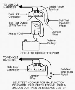

MERLIN2021
  • 17,250 POSTS
Do this and count the flashes...Count the flashes, a 22 will flash as 2 flashes then a short pause, then 2 flashes, if more than one code is stored, the pause will be longer. The codes will display three times and end with 11 or 111. Write them down and post here. First do this with the key on engine off, then again with it running.

MPARKER71
That was the first thing I tried. Once the key is shut off after driving over 25MPH. Lights goes out and there are no codes. Used a code scanner for the first try and the pigtail voltmeter combo for the second try.

MPARKER71
Sweet, thanks for your help. Dropped the pan, filter was in tight, replaced the solenoid pack, seems to be operating normally.
