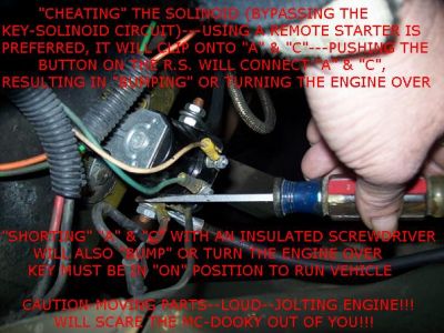

How to bypass starter relay-For what-what's wrong with it-to activate the stater motor just short out the battery terminal on it to the small terminal mark S this will crank the engine over without the key-

Basically to "OVERRIDE THE KEY" you must Connect, The Battery Positive cable to the "S TERMININAL" of your Solenoid, USING A SHORT JUMPER WIRE (Briefly, for seconds, this will act like the key is cranking it) This will only work if the solenoid is good.
https://www.2carpros.com/forum/automotive_pictures/411289_CHEATING_THE_SOLINOID_1.jpg
The Screwdriver Trick only works if Both of these items are side-by-side on the solenoid (thats why I recommend that the CJs wire exactly like mine, in pic, So "A & C" or rather wires, "1 & 5" can be EZily "shorted" with a REMOTE STARTER or a screwdriver, in a pinch!
To override the whole Solenoid, connect "A & B" or wires, "1 & 2" Temporarily, with a Heavy Cable, such as connect one side of your jumper cables to POS BATTERY, then touch the heavy starter wire firmly with the other end.
You will have SPARKS, NOISE and ENGINE MOVEMENT, when you do this.................You might have to clean out your britches, too!.........SO BE CAREFUL!!!!!!
