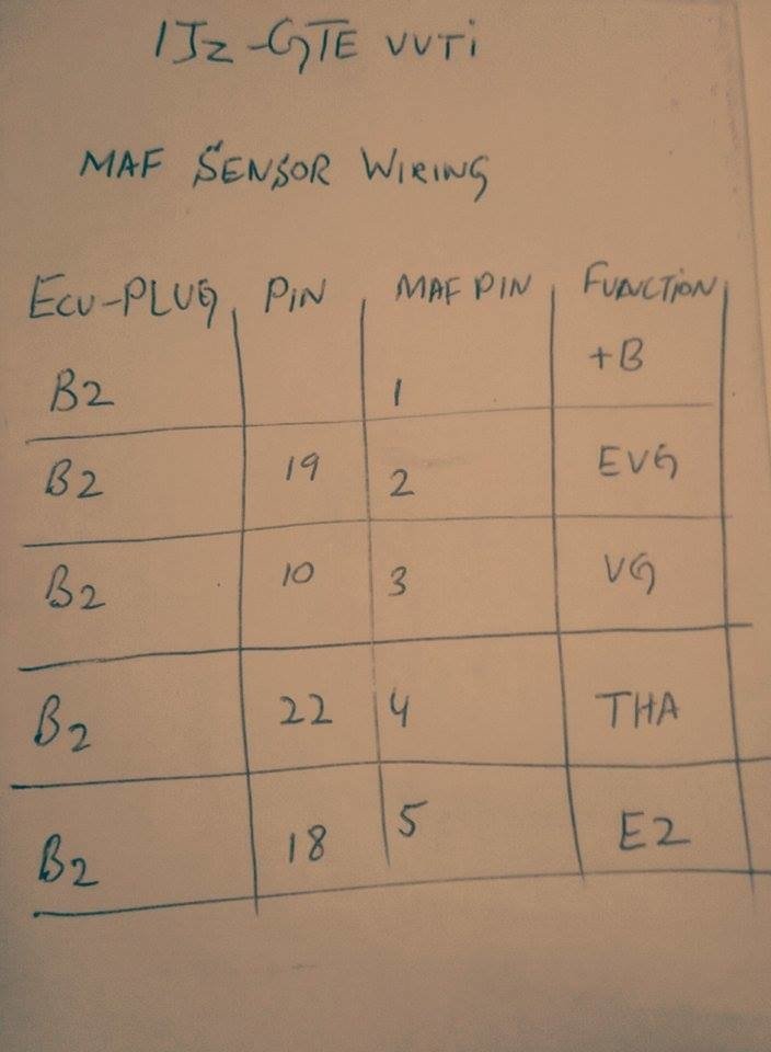

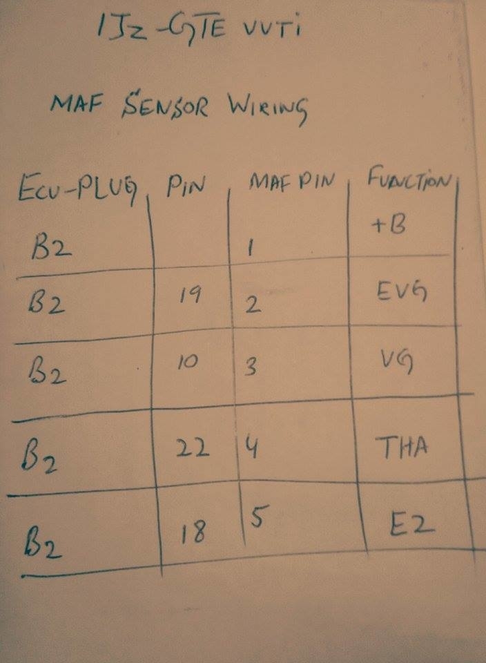

FRAZALI
Toyota Mass air flow wiring 1jzgte vvti
Jan 24, 2016 at 2:24 PM
