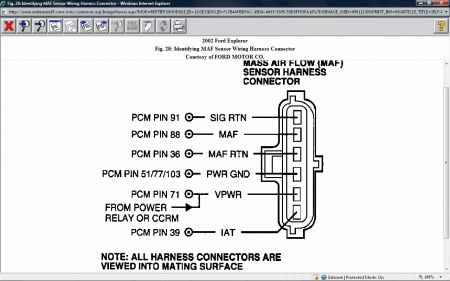

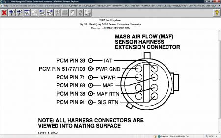

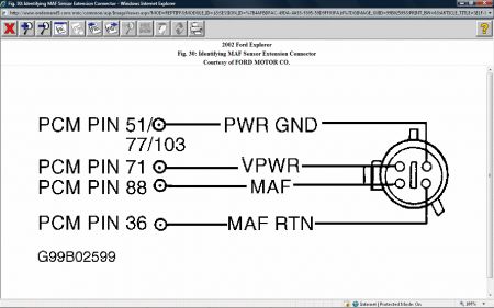

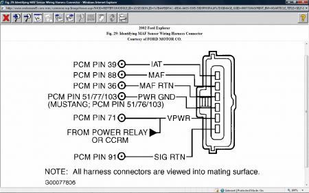

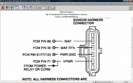

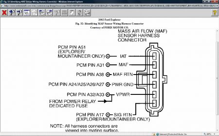

Is the MAF sensor on my explorer sending a voltage signal or a frequency to the PCM? Which one of the wires is sending the signal to the PCM. There are 6 wires, they are L-R
1- Grey
2- Blue w/ red stripe
3- Grey w/ orange stripe
4- Black
5- Purple
6- Grey w/ red stripe
Jun 28, 2008 at 8:43 AM
MERLIN2021
  • 17,250 POSTS
There are a few I will post, go by the shape of the connector, and the number of wires...
https://images.2carpros.com/forum/automotive_pictures/62217_Maf_Connector_1.jpg
https://images.2carpros.com/forum/automotive_pictures/62217_Maf_Connectora_1.jpg
https://images.2carpros.com/forum/automotive_pictures/62217_Maf_Connectord_1.jpg
https://images.2carpros.com/forum/automotive_pictures/62217_Maf_Connectorc_1.jpg
https://images.2carpros.com/forum/automotive_pictures/62217_Maf_extensiona_1.jpg
https://images.2carpros.com/forum/automotive_pictures/62217_Maf_extensionb_1.jpg

The pics help me with identification of the wires. The first part of the question though, is the MAF sending a voltage or a frequency based signal back to the PCM?
Jun 28, 2008 at 5:25 PM
MERLIN2021
  • 17,250 POSTS
I would say voltage, no testing that I know of instructs us to test for radio freqquencies! Testing always invloves volts, amps, or ohms...
