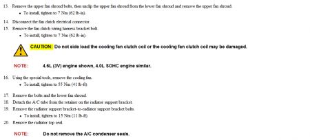

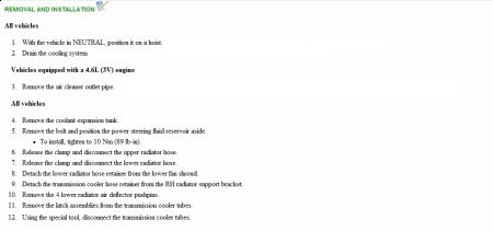

Can anybody tell me how to remove the radiator from a 2007 Ford Explorer? I had all the lines, shrowd, overflow, etc. removed. I got to the point where it was physically loose. I could raise it about 3/4" but it would hit the support bracket for the condensor (which projects over the lower tank of the radiator) Please don't tell me that I have to remove the whole support & AC. You would think that it would just slide right out.

BLUELIGHTNIN6
  • 16,542 POSTS
https://images.2carpros.com/forum/automotive_pictures/261618_Noname_1865.jpg
https://images.2carpros.com/forum/automotive_pictures/261618_Noname2_592.jpg
https://images.2carpros.com/forum/automotive_pictures/261618_Noname3_230.jpg
Mar 11, 2010 at 9:55 AM
