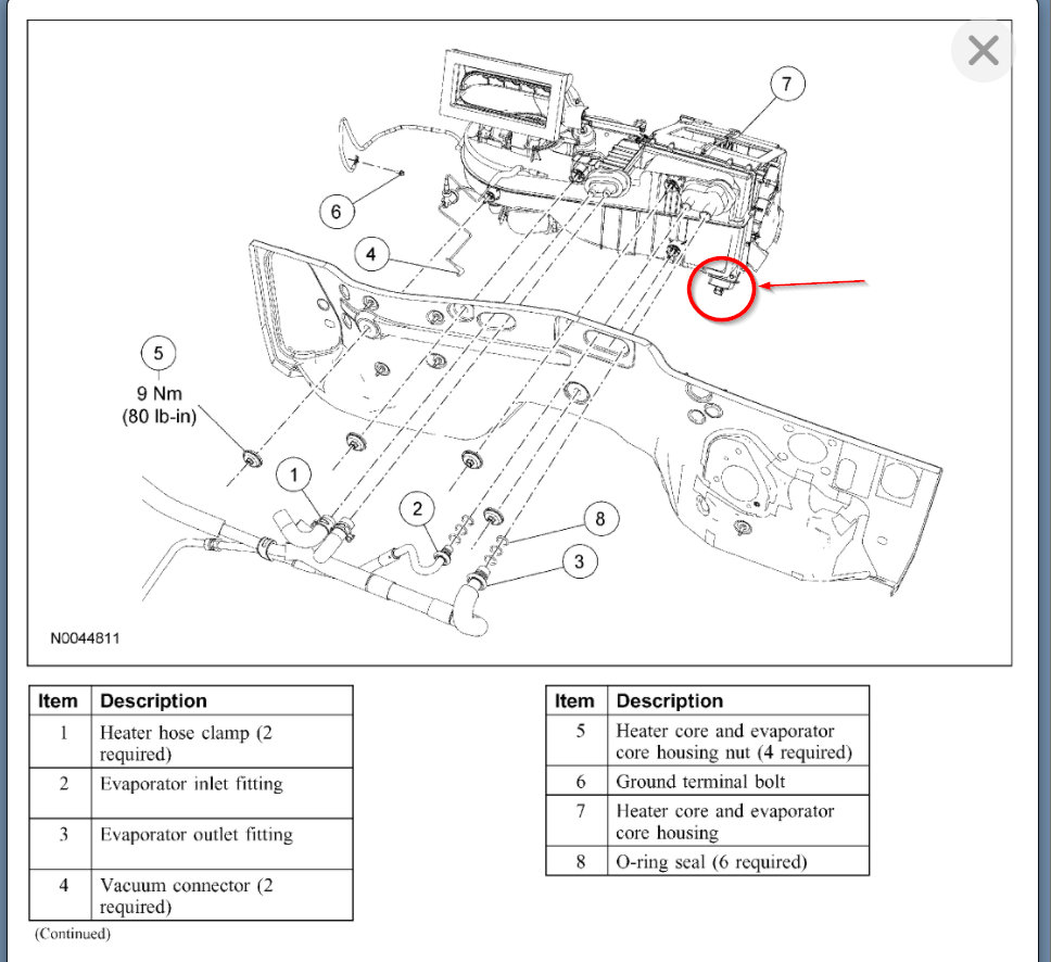

Where is the ac evaporator core drain located, so I can unclog it? Thanks.

The drain is located on the driver side of the HVAC housing. Please take a look at the image below and see if you can locate it.
More then likely you will have an extension line coming off of this port which will be a rubber line. You may have to remove this in order to really clean it out.

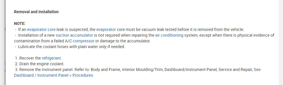

Please review this material and let us know if you have other questions. Thanks
