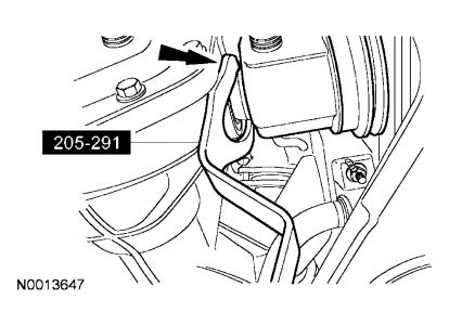

FRONT DRIVE HALFSHAFTS -2005 Ford Explorer

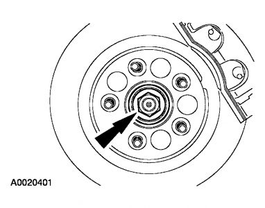

CAUTION: Do not loosen the front axle wheel end nut until after the wheel and tire assembly are removed from the vehicle. Wheel bearing damage will occur if the wheel bearing is unloaded with the weight of the vehicle applied.
1.With the vehicle in NEUTRAL, position it on a hoist. For additional information, refer to JACKING AND LIFTING .
2.Remove the front wheel and tire assembly
3.Remove and discard the front axle wheel end nut.
To install, tighten to 250 Nm (184 lb-ft).

CAUTION: Do not use a hammer to separate the outboard CV joint from the hub. Damage to the threads and internal CV joint components can result.
5.Using the special tool, press the outboard CV joint until it is loose in the hub.
6.Remove the tie-rod nut.
To install, tighten to 70 Nm (52 lb-ft). 7.Using the special tool, separate the tie-rod from the knuckle.

CAUTION: Do not allow the knuckle to hang freely. It is possible to overextend and internally separate each inner CV joint from its housing.
10.Using the special tool, disconnect the upper ball joint from the knuckle.

https://www.2carpros.com/forum/automotive_pictures/99387_Graphic2_23.jpg
https://www.2carpros.com/forum/automotive_pictures/99387_Graphic3_10.jpg
https://www.2carpros.com/forum/automotive_pictures/99387_Graphic4_4.jpg
