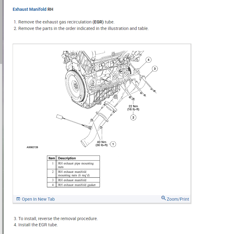

My explorer has a bad exhaust leak, I see that two of the exhaust studs are broken on the passenger's side.

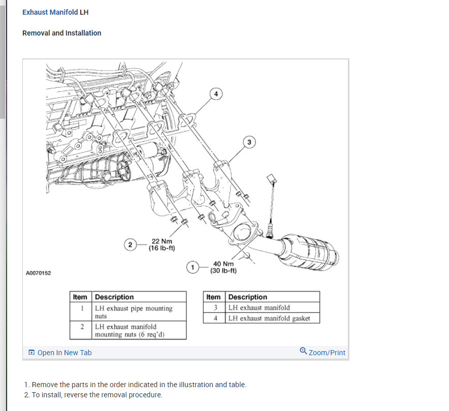

Below is the process from the manual that will help with the detail needed as well to complete this.
However, if you broke the studs then you need to continue with the others and remove the manifold and then hope there is enough stud left that you can extract it. If not, you are going to have to try and drill it out otherwise you are going to need to remove the head and take it to a machine shop.
Please keep us posted on what happens. Thanks
