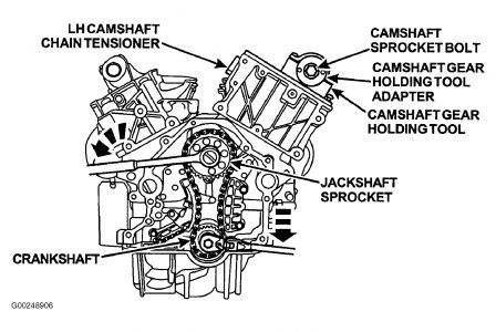

Also, I don't know if it is the tensioners, guides, or what and if it's the front or rear. I have read if it's the rear the engine has to come out and it will require a special tool for the timing.
I don't even know where these tensioners are located at.
Since the truck is still running, thus the timing hasn't taken a walk on me yet, I'm wondering if I could replace the front tensioners (the screw in type from what I understand by reading other info on this) and see if that fixes the problem. Would I really need to replace the chain or anything if it hasn't broke or skipped yet?
Jul 24, 2010 at 8:52 PM
OBXAUTOMEDIC
  • CAR REPAIR CONTRIBUTOR
  • 3,711 POSTS
No as long as the chain hasn't jumped you don't really need to change the chain. You can try replacing the tensioner on the left side to see if by chance that is the problem. Remove upper intake manifold. Remove thermostat housing. Remove left camshaft tensioner. To install, reverse removal procedure. If using a new washer, tighten to 32 ft. lbs. (44 N.m). If using old washer, tighten to 49 ft. lbs (67 N.m).
https://images.2carpros.com/forum/automotive_pictures/188069_97exploderlhtimtens_1.jpg
If that doesn't fix it then it look like the front of the engine will need to be torn down to replace the Guides or Cassetts as calls them. .
