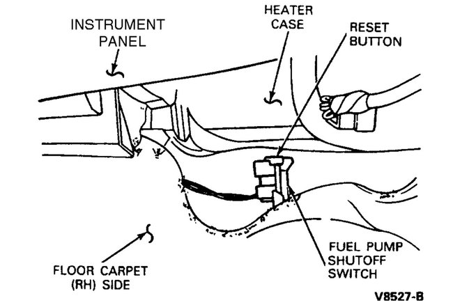

INERTIA FUEL SHUTOFF SWITCH LOCATION
Inertia Fuel Shutoff Switch Location
https://www.2carpros.com/forum/automotive_pictures/12900_inertiaswitch_1.gif
Located on the toe-board to the right of the transmission hump.

I think the fuel pump shut off switch was triggered while driving down our super bumpy full of potholes drive way. It turns over but will not start. The problem is, I don't know what this switch looks like. I kind of have an idea of where it is but can't find it.
Can you show me what it looks like and where to find it
Thursday, November 26th, 2020 AT 8:33 AM (Merged)
  • 75,992 POSTS
Explorer its on the right side of transmission hump, underneath carpet on toe board. There will be a shrouded reset button on top
See the diagram below for location

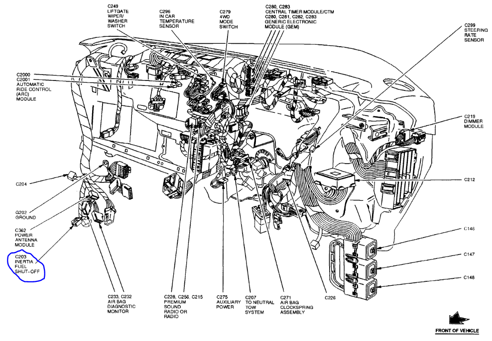

DANNY L
  • 5,648 POSTS
Hello, I'm Danny.
Yes, the inertia switch is located in the right kick panel. I've attached a picture below. To reset the switch use a finger to depress the button. Hope this helps and thanks for using 2CarPros.
